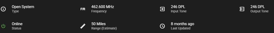

I am using a local repeater on 462.600. Works fine with my Baofeng HTs. Input and output tones are DCTS 246. I programmed the Baofengs with CHIRP. The Midland cannot be programmed. You have to use the menus on the unit. I turned on the repeater settings using the Midland menu. I can hear traffic from my HT through the repeater. I can talk from my Baofeng to the Midland just fine. But I cannot  transmit to the Baofeng from the Midland. I set the DCS Privacy number to 90 which corresponds to DCS code 246 according to the chart in the Midland manual.
