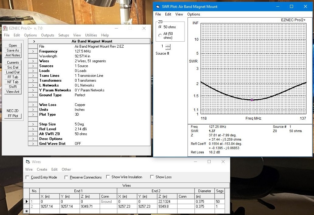

0 Lscott Posted October 20, 2025 Posted October 20, 2025 2 hours ago, WRUE951 said: I wasn't sitting in the vehicle.. I was parked near a Hanger with my friends playing with aircraft stuff. You have any air-band radios? https://forums.mygmrs.com/gallery/image/534-ic-a16-air-band-radiojpg/?context=new I did some simulations to see what it takes to cover the 118 to 137 MHz range. Doesn't look possible without using a 3/8 inch diameter vertical element to get under a 2:1 SWR. Quote

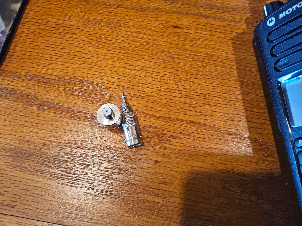

0 HHD1 Posted October 20, 2025 Posted October 20, 2025 On 10/18/2025 at 8:49 PM, amaff said: When you say "portable" do you mean handheld? That's definitely a thing. Usually you'll need something like this (just make sure it's the right connector for both your antenna and radio) https://www.amazon.com/dp/B00COWFD6I On 10/18/2025 at 9:17 PM, Destro said: The Nagoya UT-72G mag mount antenna comes with the adapter for a handheld. It's fairly cheap and works great. This is the setup I currently run with my handhelds. Plug in a hand mic and you're good to go. Much better than any antenna inside the vehicle. Destro and amaff 2 Quote
0 WRUE951 Posted October 20, 2025 Posted October 20, 2025 1 hour ago, Lscott said: You have any air-band radios? https://forums.mygmrs.com/gallery/image/534-ic-a16-air-band-radiojpg/?context=new I did some simulations to see what it takes to cover the 118 to 137 MHz range. Doesn't look possible without using a 3/8 inch diameter vertical element to get under a 2:1 SWR. we weren't using Airband.. We were on a UHF Ham frequency. But to answer your question, i do have radios capable of Airband but never used them for that purpose. Lscott 1 Quote
