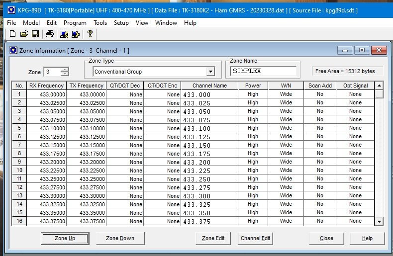

I would recommend you look at the Kenwood TK-3180 HT, specifically the 400-470MHz band split. While not Part 95 certified, the 450-520MHz split is, it's a good radio, 512 channels, but somewhat bulky. Some people don't care if the radio has Part 95 certification and so far the FCC hasn't bothered anyone using such radios so long as they are programmed to comply with the rules. The 450-520MHz version is much easier to find. They can also be "pushed" to operate in the Ham 70cm band, at least in the repeater section.

While true in the general case there are exceptions. For example my NX-1300DUK5 is front panel programmable. The procedure is outlined in the service manual. Some radios you have to purchase a license to enable it. In the case of the NX-1K series it's included for free. Just have to enable it in the programming software and load the code plug into the radio.
One one thing you generally don't get is a true "VFO Mode" in the radio. I typically work around that by programming a sequence of memory channels with the usual channel spacing and use the frequency as the channel name tag. Thus when scrolling through the memory channels it looks like you have a VFO with a fixed frequency step size. The more channels you have the wider the range you can cover this way.
NX-1200_1300 Front Panel Programming.pdf

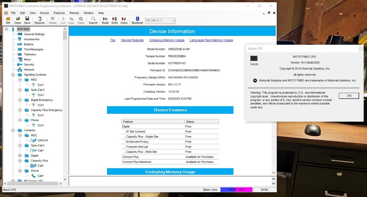

For the Motorola fans the XPR6550's are good radios. Just be sure you get the 400-470 MHz band split version without the trunking firmware loaded in it. Also make sure it hasn't been programmed using Motorola's CPS 2.0 software, and some report it sucks. Once "touched" by that you're stuck using it forever. The best version is the older CPS 16 Build 828. I have patch files for it to clear passwords and enable wide band over the full range.
The radios use a near enough standard SMA antenna port so with an adapter an external antenna can be used.
The radios will do narrow, and wide band with the patch, FM plus DMR, total of 1000 channels.
I picked up a few just to try out for a reasonable price on eBay, at the time I paid about $100 to $150 each.
The XPR7550's are a better radio, but use a weird stud type antenna port. Since I like to use my radios mobile a standard antenna port is a requirement for me at least.
https://forums.mygmrs.com/gallery/image/261-motorola-xpr6550jpeg/?context=new
