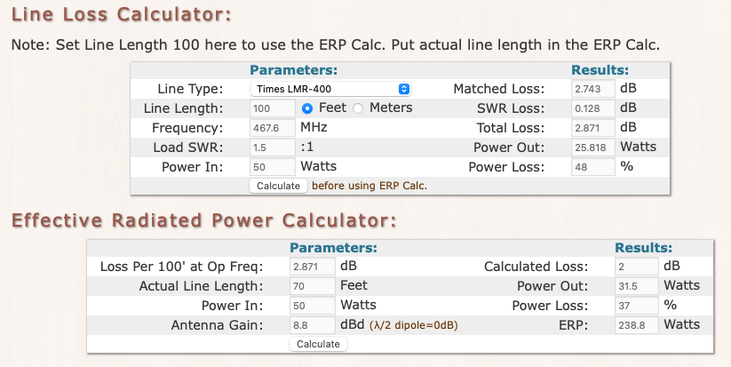

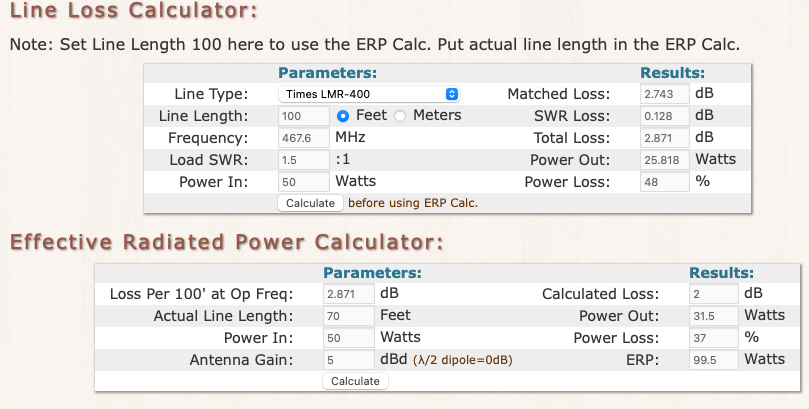

Okay, let me see if I got the information correct.
You are currently running 50 ft of LMR400
Your mast is 35 ft and you want to go to 55 ft
That means you will go from 50 ft of coax to 70 ft of coax.
I ran the numbers on the kv5r coax calculator
You will be fine even with LMR400 if you are running an antenna with at least 4-5 dBd of gain.
You definitely want to use lightning arrestors right before the coax enters your house. Also make sure they are connected to a close ground rod too. Lightning arrestors won't do much good if they aren't grounded.
You can use LMR400 Ultra Flex, RG8 or even RG8X for short jumpers. Loss will be very minimal even with RG8X if the jumpers are kept to 6 ft long or shorter.

More info
Most coax loss calculators use gain listed in dBd. To go from dBi to dBd, subtract 2.15 from the gain in dBi. So your antenna with 11 dBi go gain is actually 8.85 dBd.
Most manufacturers market their antenna gains in dBi to make them look better. My calculations posted above was using an antenna with 5 dBd of gain.
Here are the numbers using 8.8 dBd of gain.
You will be fine sticking with LMR400 if you want to.

The OP stated his antenna has 11 dBi of gain which equals  8.85 dBd of gain.

Look at the numbers posted. Any antenna with 11 dBi of gain will have 8.85 dBd of gain. It's simple math. subtract 2.15 from the gain given in dBi to get the gain in dBd.  I just rounded it to 8.8 for simplicity.
