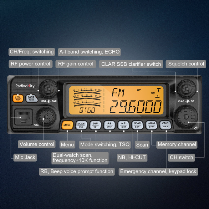

TNFrank Posted December 17, 2025 Author Posted December 17, 2025 1 hour ago, hxpx said: It's tiny, but you can do SSB from 28.300 to 28.500 on a technician. [source] Edit, dang, WRYS709 beat me to it. I noticed that. I guess it's better than nothing. I have that radio in my list on Amazon but it's still $259. SteveShannon 1 Quote
hxpx Posted December 17, 2025 Posted December 17, 2025 2 hours ago, TNFrank said: I noticed that. I guess it's better than nothing. I have that radio in my list on Amazon but it's still $259. Yeah, nothing on HF is cheap. Except maybe wire. Quote
SteveShannon Posted December 17, 2025 Posted December 17, 2025 If you really want to get started in HF, I would strongly recommend a radio that does more than just 10 meters. You’ll spend way more time on 40 and 20. The Xiegu G90 is a 20 watt output radio that does 160-10 meters, has a small but usable color spectrum scope, and a really good built in impedance matching “antenna tuner” that can handle up to 10:1 impedance mismatch. It’s available for about $430 in a kit with a digital interface and cooling stand. When you decide to go for a larger, more full featured radio from Icom, Yaesu, Kenwood, etc., the G90 would be a great mobile or even go bag radio. Jaay and AdmiralCochrane 2 Quote
TNFrank Posted December 17, 2025 Author Posted December 17, 2025 My Technician's license only gets me down to 10M so there's no point in getting a radio that'll do 20M or 40M. One that would do 10M, 6M, 2M, 1.25M and 70cm would really be nice. Quote
WRYS709 Posted December 17, 2025 Posted December 17, 2025 3 hours ago, TNFrank said: I noticed that. I guess it's better than nothing. I have that radio in my list on Amazon but it's still $259. the difference in price for it being more expensive on Amazon is their return policy. As I mentioned it is only $176.11 tonight on Radioddity's site: https://www.radioddity.com/products/radioddity-qt60 you will of course need to invest in an antenna too. Radios that do HF and VHF/UHF get VERY expensive. SteveShannon 1 Quote

wayoverthere Posted December 17, 2025 Posted December 17, 2025 13 minutes ago, TNFrank said: My Technician's license only gets me down to 10M so there's no point in getting a radio that'll do 20M or 40M. One that would do 10M, 6M, 2M, 1.25M and 70cm would really be nice. Except the slice of 10m that Techs have access to is specified for SSB phone (not FM), and all the 10/6/2/.70 radios I can think of are FM only. More generally, are you thinking toward upgrading to General in the future? IMO, the jump in difficulty from Tech to General is a lot smaller than from General to Extra (spoken as a General studying toward Extra). If General is in the cards , consider whether it's worth a "buy once, cry once" jump now, play with 10m, and then you're better set for the future. Also, TX aside, you can listen to other bands all you want, even as a Tech (or not even ham licensed)....if that interests you. 4 hours ago, WRYS709 said: You have a 2x3, which is what most Technicians have. Once you pass General, you would retain your 2x3 unless you apply for a Vanity Call within the General callsign parameters (1x3 if available) So one cannot tell which Class license for sure, unless their newer call is shorter than 2x3. A Technician, in addition to CW, can do digital, like FT8 and YOU CAN do SSB from 28.3 to 28.5! Minor correction; FCC lumps General and Tech together in the C & D group calls (1x3 and 2x3), with Extra getting access to the 1x2, 2x1, and 2x2 calls. From personal experience, while I was still a Tech, I chose to request a vanity call ahead of the fee implementation, shortening my sequentially assigned 2x3 (KN6) to a 1x3 (K6), but retained the same suffix as assigned. (Tech in 3/2021, did the vanity 7/2021, upgraded to General 6/2023) IIRC, when you level up to General and Extra, there's a box you can mark to request a new sequential call as well. https://www.fcc.gov/wireless/bureau-divisions/mobility-division/amateur-radio-service/amateur-call-sign-systems so...a 1x2, 2x1, or 2x2 is a dead giveaway of a higher class (Advanced or Extra) TNFrank, AdmiralCochrane and SteveShannon 2 1 Quote

WRYZ926 Posted December 18, 2025 Posted December 18, 2025 And a dipole hung as an inverted V is horizontally polarized but it is more omni directional. I started out with a 10m inverted v dipole and worked all over the world with it on FT8 and SSB. Yes a technician can use digital modes such s FT8/4 on 10m. FT8/4 allows you to work those weak signals that you would never be able to work on SSB. I personally would not recommend one of those cheap import 10m radios. Unless you never plan on using anything other than SSB mode and you never plan on upgrading to general or Extra. The Xiegu G90 is a great little 20 watt HF radio. The downside is it does not work on 6m. I use a G90 for POTA. You won't find any radio that does all modes on just 10m, 6m, 2m, and 70cm. You are going to want an all mode since you can only use CW/digital and SSSB on 10m as a tech. There are radios (shack in the box, that does all modes and all bands from 160m - 70cm such as the Yaesu FT-991, Icom IC-7100, and some Kenwood radios. I'm not a fan of shack in the box radios since you are putting all your eggs into one basket. Most will do 100 watts on HF and 6m, 50 watts on 2m and 25-4- watts on 70cm (depending on brand/model) Most HF radios will work on all of the HF bands and 6m. You can get mobile HF radios or base station radios. The majority will do 100 watts on HF and 6m. If you want an all mode/all band radio and are on a tight budget, then look for used radios. The Icom IC-706MkII-G can be found for decent prices. I just picked up a 706MkII-G for $400 a couple of months back. When it comes to call signs. Some will keep their original call sign even after upgrading while others want a certain vanity call sign. Others wait until they get their Amateur Extra before getting a vanity call sign so they can get a short call sign for working CW. I won't bother with a vanity call sign until I upgrade to Extra and get proficient at CW first. SteveShannon 1 Quote
