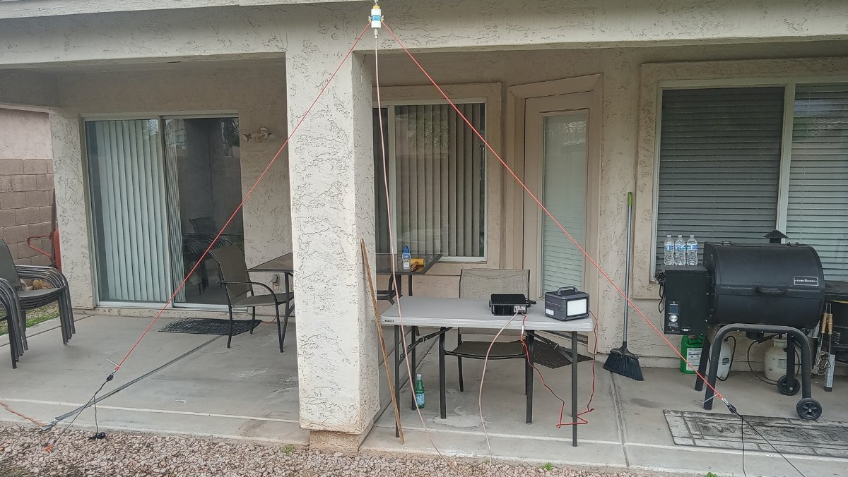

WRQC527 Posted January 2 Posted January 2 It appears from the picture that your inverted V antenna is about a foot away from your house. Embedded in all that stucco is a whole lot of chicken wire. While the inverted V is somewhat more omnidirectional than a standard "flat-top" dipole, a lot of your transmitted signal is probably getting eaten up by the house, and it's also affecting your SWR and wreaking havoc on the radiation pattern. If you can get it out in the open, you might have better luck. Just my two cents, which when adjusted for inflation, is down to just over a penny. WRYZ926 1 Quote
TNFrank Posted January 2 Author Posted January 2 I was going to try mounting it on the tripod I'd set up for a yagi antenna I have but it wouldn't have been any higher. I know that the wave pattern to the South is probably very compromised. North seems to be decent though because I've made some contacts with Canada and even got one today from Alaska. I think I will try moving it out though just to test it if nothing else. The way I have it now was just for convenience more than any thing just so I could get on the air. Now I can start tweaking things to see what will work better. WRQC527 1 Quote

TNFrank Posted January 2 Author Posted January 2 Moving the antenna out away from the house and having it up maybe another 6 to 8 inches has made a real difference. According to the meter on the radio my SWR is less than 1.5:1. I was hearing a lot of folks, some very strong but didn't get a QSO from any of them. On the other hand, some 5/4 signals were coming in for POTA that I made contact with. I helped to activate 3 POTA QSO's and got them in my QRZ log. I also got some video footage that I'm going to try and cut together into a YouTube video. SteveShannon and WRYZ926 1 1 Quote
SteveShannon Posted January 2 Posted January 2 45 minutes ago, TNFrank said: Moving the antenna out away from the house and having it up maybe another 6 to 8 inches has made a real difference. According to the meter on the radio my SWR is less than 1.5:1. I was hearing a lot of folks, some very strong but didn't get a QSO from any of them. On the other hand, some 5/4 signals were coming in for POTA that I made contact with. I helped to activate 3 POTA QSO's and got them in my QRZ log. I also got some video footage that I'm going to try and cut together into a YouTube video. Way to go!!! That gives proof to the saying about antennas ”Everything affects everything!” TNFrank 1 Quote
