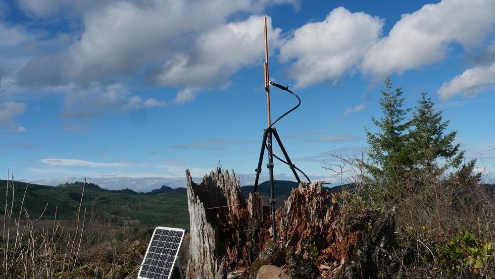

I do the same setting up a Retevis repeater for camp. Started with the roll up, but had better luck with a copper J-Pole.. Here I had it on a camera tripod that worked great on top of the hill, but have since went with a telescoping flag pole.. On the top of the hill though the tripod was all I needed.. The benefit of the tripod was the short length coax with little loss.. Probably a wash with what you gain going up, then lose it in coax loss..
 One thing we got here is plenty of hill tops and ridges.. LOL
