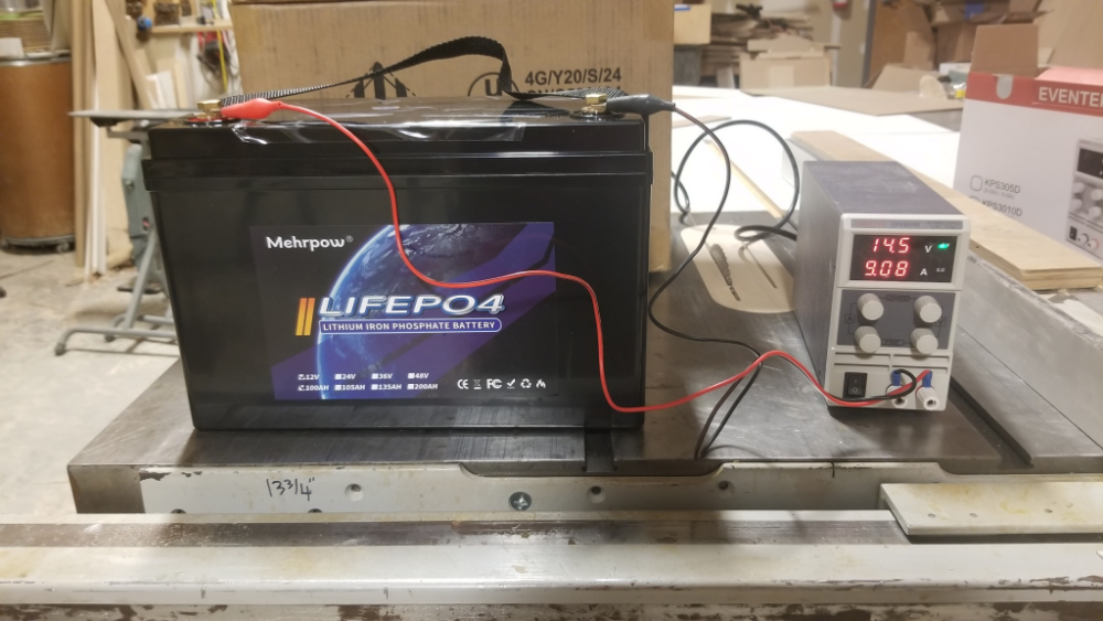

Just picked up my first LiFePO4 100Ah battery.  On sale from Amazon, pretty good reviews.  Built in bluetooth to monitor the BMS.  Never heard of the brand, but lots of people seem to like them so for $150 I'll give it a shot.  Charging it with my variable bench power supply since I don't have a dedicated charger for it yet.  Backup for my repeater.
I am going to suggest getting the correct charger for LIPO4 batteries. A charger for lead acid and AGM batteries can actually damage a LIPO4 battery.  I don't know if a bench top power supply will cause any damage or not.
