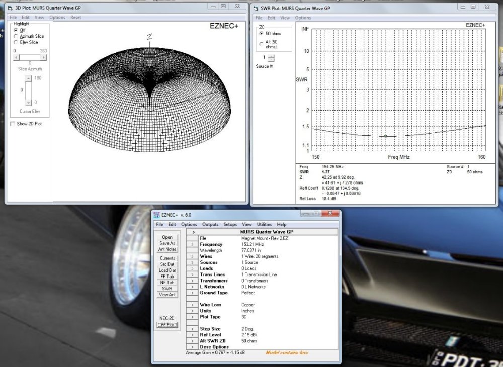

31 minutes ago, Borage257 said:
Cut it for MURS (153 MHz) and it will be pretty good on GMRS too!
If he does that it will may look OK from an SWR standpoint but the pattern will look bad with multiple lobes likely giving crummy coverage. I wouldn't recommend it other than as an experiment.
OK.
I simulated a simple magnet mount 1/4 wave MURS antenna. The frequency was selected to be about in the middle of the band. The results looks good. The match and radiation pattern look like what I would expect.
The exact same antenna was then run at a frequency about in the middle of the GMRS band, between the simplex and repeater input frequencies.
As you can see the match short of looks OK on GMRS, however most of the RF power shoots up at a very high angle uselessly into space. I guess if GMRS has satellites in low earth orbit it might be a good antenna. For normal ground work most of the power is wasted.
This is what I was getting at in my prior post comments.
