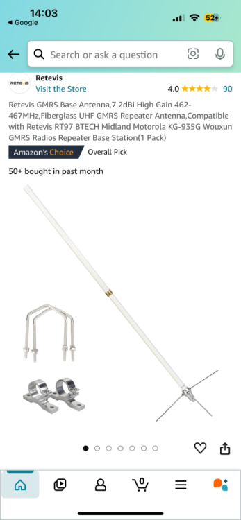

WSDE521 Posted August 6, 2024 Author Report Posted August 6, 2024 2 hours ago, WRYZ926 said: The KG-1000G and power supply combo will work well for you and make a nice base station setup. Let us know if you have any other questions or have any problems with setup. Don't forget to use a good antenna and good coax cable. Most of all enjoy your setup. If you decide to use external speakers with the radio, you will want to either use two speakers or just use one speaker for only one side. Y adaptors/splitters will not work, they cause an impedance mismatch and cut the volume levels in half if you try to use one speaker hooked to both speaker outputs on the radio. I found out the hard way by buying an y adaptor only to have the one speaker not being loud enough to hear. I decided to just use one speaker for one side of the radio. An excellent speaker is the Icom SP-35. You can get them on Amazon for $35. I found this on Amazon , is this what you use ? I am still trying to put away the money to buy all of these items, If you have any more suggestions please let me know. I am on SS and have to be cautious about how much I spend, however I am old enough to know that you get what you pay for! If it is too cheap. It’s probably junk . Quote
SteveShannon Posted August 6, 2024 Report Posted August 6, 2024 That would probably work but many people have had great success with the Comet Ca-712EFC antenna. DXEngineering has it for $140. Be sure you get the CA-712EFC which is tuned for GMRS. If you’re trying to save money, don’t get it at Amazon. It will be more expensive at Amazon!!! WRUU653 and WRYZ926 2 Quote
WRYZ926 Posted August 6, 2024 Report Posted August 6, 2024 Here is a link to the Comet CA-712EFC at DX Engineering. Cost is $140. https://www.dxengineering.com/parts/cma-ca-712efc I can't speak on the quality of the Retevis antenna. But you won't go wrong with the Comet CA-712EFC. WRUU653 1 Quote

LeoG Posted August 6, 2024 Report Posted August 6, 2024 5 hours ago, WSDE521 said: I found this on Amazon , is this what you use ? I am still trying to put away the money to buy all of these items, If you have any more suggestions please let me know. I am on SS and have to be cautious about how much I spend, however I am old enough to know that you get what you pay for! If it is too cheap. It’s probably junk . I have that antenna for my RT97S repeater and I went with the UAYESOK from Amazon which turns out to be the exact same antenna with a slightly higher price. I can easily hit the 3 repeaters near me at 7, 17 and 21 miles away. I'm using the Messi and Paoloni Hyperflex 13 cable at the house (84 foot run) and LMR400 with the repeater (50 foot run). If you live in an area with more trees and hills you want to stay away from a super high gain antenna and stick with something in the 6-8dBi range. (convert to dBd by subtracting 2.15 from the dBi value) Both the Retevis and the UAYESOK were under 1.1 for SWR with my setups. Quote
WSDE521 Posted August 7, 2024 Author Report Posted August 7, 2024 16 hours ago, WRYZ926 said: You're welcome. Here is a link to the DX Engineering MAX400 and MAX400 UF coax cables. Either one is available in many different lengths. https://www.dxengineering.com/search/department/cable-and-connectors/part-type/coaxial-cable-assemblies?N=brand%3Adx-engineering%2Bcoaxial-cable-type%3A400max_lmr-400-uf-ultraflex 13 hours ago, LeoG said: I have that antenna for my RT97S repeater and I went with the UAYESOK from Amazon which turns out to be the exact same antenna with a slightly higher price. I can easily hit the 3 repeaters near me at 7, 17 and 21 miles away. I'm using the Messi and Paoloni Hyperflex 13 cable at the house (84 foot run) and LMR400 with the repeater (50 foot run). If you live in an area with more trees and hills you want to stay away from a super high gain antenna and stick with something in the 6-8dBi range. (convert to dBd by subtracting 2.15 from the dBi value) Both the Retevis and the UAYESOK were under 1.1 for SWR with my setups. 13 hours ago, LeoG said: I have that antenna for my RT97S repeater and I went with the UAYESOK from Amazon which turns out to be the exact same antenna with a slightly higher price. I can easily hit the 3 repeaters near me at 7, 17 and 21 miles away. I'm using the Messi and Paoloni Hyperflex 13 cable at the house (84 foot run) and LMR400 with the repeater (50 foot run). If you live in an area with more trees and hills you want to stay away from a super high gain antenna and stick with something in the 6-8dBi range. (convert to dBd by subtracting 2.15 from the dBi value) Both the Retevis and the UAYESOK were under 1.1 for SWR with my setups. 13 hours ago, LeoG said: I have that antenna for my RT97S repeater and I went with the UAYESOK from Amazon which turns out to be the exact same antenna with a slightly higher price. I can easily hit the 3 repeaters near me at 7, 17 and 21 miles away. I'm using the Messi and Paoloni Hyperflex 13 cable at the house (84 foot run) and LMR400 with the repeater (50 foot run). If you live in an area with more trees and hills you want to stay away from a super high gain antenna and stick with something in the 6-8dBi range. (convert to dBd by subtracting 2.15 from the dBi value) Both the Retevis and the UAYESOK were under 1.1 for SWR with my setups. Thank you very much, this is very helpful, I will have to purchase all the equipment one or two at a time, but I will definitely take your advice. Right now we are having a tropical storm and looking at 30”’s of rain not going to be able to do anything outside for a days anyway. But I think I will get the antenna and coax first and get it set up and anchored to my house and cemented in the ground. Then save the money to purchase the Radio and power supply, . That I can do inside regardless of the weather. We are in Hurricane season here in Myrtle Beach SC . I want to thank everyone on here for being so supportive and giving me suggestions on what I may need to purchase. WRYZ926 1 Quote
