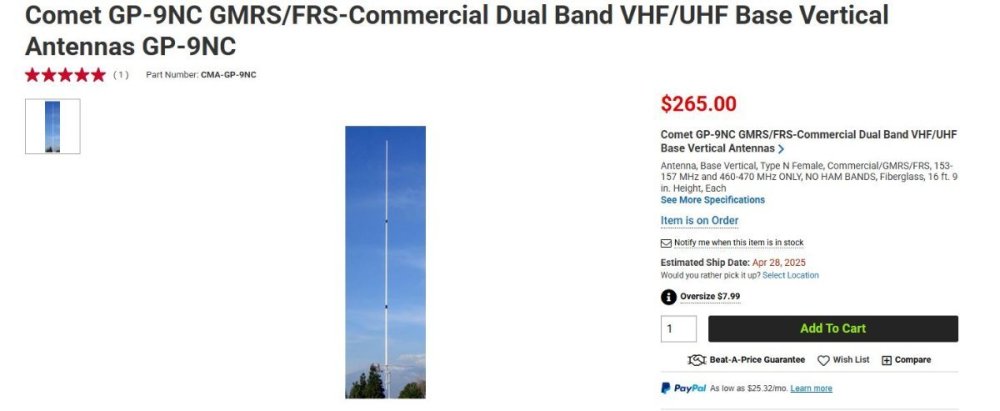

GrouserPad Posted April 10 Report Posted April 10 On 10/14/2024 at 4:59 PM, MarkInTampa said: The GP-9NC (GMRS/MURS) is rated 153-157MHz and 460-470MHz. The straight GP-9 and GP-9N (ham version) is rated 144-148 and 440-450MHz. I just got one of these antennas and the paperwork with it does not show it covering 467 MHz. Think it cut off at 465mhz. Has me wondering if maybe the newer gp9nc antennas aren’t purpose built for gmrs….anybody know? Ordered from engineering and their online showed it covering to 470mhz. . . Then my paperwork that came with my gp9nc said ham only. Ugh ? Wish I had an antenna analyzer to check it before I put this thing up. Quote
WRYZ926 Posted April 10 Report Posted April 10 The GP-9 (PL259) doesn't say it covers GMRS in the paperwork either. But the SWR is 1.8 or less across all GMRS channels, 2m and 70cm. Others have tested their GP-9 antennas and the SWR was above 2.0 on GMRS. So each antenna does need to be checked. WRUU653 and SteveShannon 2 Quote
WRYZ926 Posted April 10 Report Posted April 10 2 minutes ago, Socalgmrs said: I’ve got a 9nc and it works amazing.  I was only getting 200miles with my 712efc and a 20w.  Now 250miles with the 9nc and 20w and even more hooked to my new 50w. Again, you live in an area that allows that. Most people will never see those kinds of ranges. Your range of 200+ miles in very unrealistic for the majority of people. SteveShannon and WRCQ487 2 Quote
MarkInTampa Posted April 10 Report Posted April 10 2 hours ago, GrouserPad said: I just got one of these antennas and the paperwork with it does not show it covering 467 MHz. Think it cut off at 465mhz. Has me wondering if maybe the newer gp9nc antennas aren’t purpose built for gmrs….anybody know? Ordered from engineering and their online showed it covering to 470mhz. . . Then my paperwork that came with my gp9nc said ham only. Ugh ? Wish I had an antenna analyzer to check it before I put this thing up. The advertisement for the GP-9NC shows it as a GMRS antenna and covers 460-470MHz. The GP-9 and GP-9N (no C at the end) are ham only. The letter "C" is Comet's designation for the commercial band (kinda where GMRS resides) - not ham. The letter "N" means it has a "Type N" connector and the straight GP-9 is ham only with a SO-239 connector. When I got mine, the bag it came in said it was GP-9N and they put on a tiny sticker with the letter "C" at the end of it. My guess is they didn't want to print up new packaging to add a letter. I don't remember what paperwork it came with though (ham or GMRS) but I didn't have to tune it. SteveShannon, GrouserPad, WRYZ926 and 1 other 4 Quote
WRYZ926 Posted April 10 Report Posted April 10 Yes the C does designate commercial which means that the antenna will work in the 2m business/MURS portion and the UHF business and GMRS. That being said, a lot of times, but not always, the GP-9 and GP-9N amateur band antennas will also work for GMRS. The only way to know is to test the SWR. Quote
LeoG Posted April 10 Report Posted April 10 Ya, I just got the CA712EFC and the "C" is just a sticker they put on. 1st time I bought the antenna I emailed the company and they said that's the way they do it. 2nd time I ordered the antenna it was the same. No need to email the company, had already been through it. GrouserPad 1 Quote
GrouserPad Posted April 13 Report Posted April 13 To update this: friend ordered the same antenna as me(gp9nc) from a different comet dealer. Both antennas come with the ham band paperwork and show the working frequency as 155mhz to 465mhz(close enough for gmrs of course) Both antennas had paperwork that stated "Ham bands only". Not a big deal at all but as a new buyer you would be slightly concerned thinking maybe you got sent the "other" gp9n available rather than the nca. Anyhow carry on. Thanks guys ya'll always offer tons of info to me so paying it forward with this post if anyone else comes across a similar concern. Jaay 1 Quote
