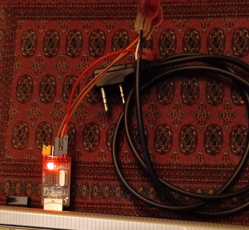

You can always make your own.....this one had a counterfeit chip so I got some UART's and made this.....I am using Win 7 no problems
This one shows up on com port 4 and works great.
Except that the DB20-G is an RJ-45 connector and not the K-1.
is that a “Miklor” DIY cable? They do have a DIY K-1 to RJ-45 adapter which allows my FTDI K-1 cable to work on the DB20-G.
It still has to connect to the usb - do you know the pin configuration of the 'rj45' connector --- in telco pins 4 and 5 are for line 1 but I forget the
data pins - I usually follow the color code for cat 5 on them.
Yes it is a "miklor" the input/output should be the same - gnd, tx, rx
