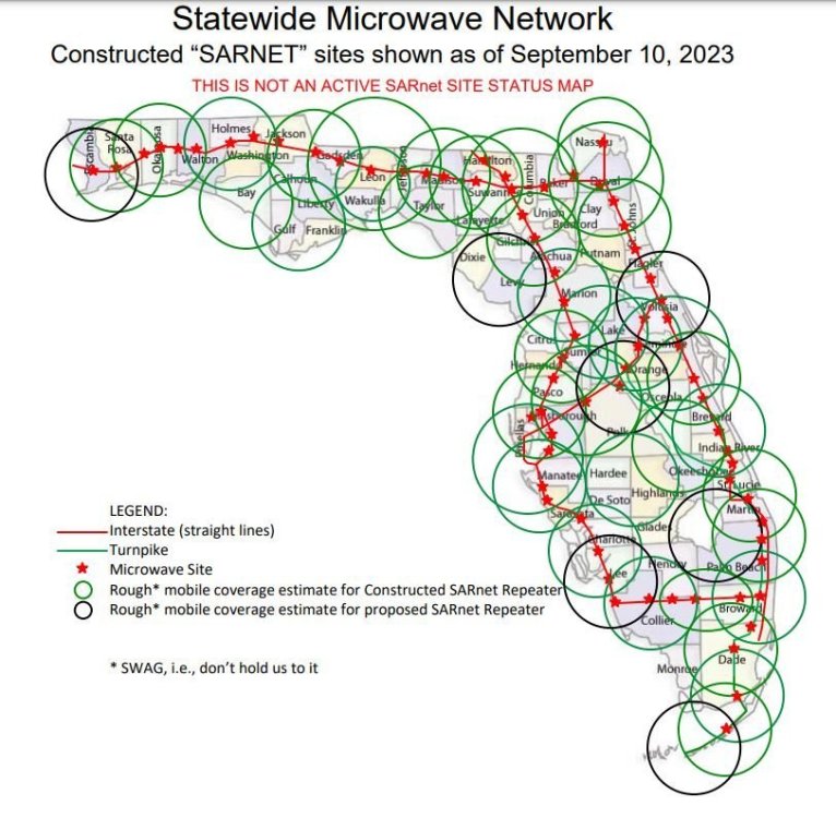

MarkInTampa Posted October 7, 2024 Report Posted October 7, 2024 2 hours ago, Lscott said: Looks like Hurricane Milton is headed for central West Florida. https://www.usatoday.com/story/news/weather/2024/10/07/hurricane-milton-tracker-path-spaghetti-models/75551975007/ That area is well covered by an extensive Ham NXDN digital network. https://ni4ce.org/nxdn-digital-communications/ It's covered even better by SARNET (https://sarnetfl.org/) Lscott 1 Quote
Lscott Posted October 8, 2024 Report Posted October 8, 2024 That is a VERY extensive network. I wonder if there is any linking between that network and the NXDN one? Quote
MarkInTampa Posted October 8, 2024 Report Posted October 8, 2024 11 hours ago, Lscott said: That is a VERY extensive network. I wonder if there is any linking between that network and the NXDN one? Two different groups run them so I couldn't tell you for sure. The SARNET system runs across the FDOT's (Florida Dept of Transportation) microwave network and towers. I've been to a few of the tower locations - it was kind of strange. The microwave network runs T3/DS3 (54mbs) protocol as a backbone, then divided into T1/DS1 (1.5mbs) lines and then further divided into 56/64k lines. There was even a old analog rotary dial telephone connected using a ancient PBX adapter that still worked at each location. It was like looking at a telco room from the 1960's. DOT is really well connected in Florida using both microwave and fiber they own. Almost everything that ran on the microwave is now running on fiber. Up until 5 years ago almost all the interstate was covered with fiber and have PTZ cameras installed every 2 miles and MVDS (Microwave Vehicle Detection System) every mile with the exception of 130 mile or so stretch of I-10 between Jacksonville and Tallahassee and that's what I helped put in, now it's close to 100%. Now almost everything that was running microwave has been switched to fiber and the microwave network is basically abandoned except for the SARS repeater system. I talked to one of the FDOT IT directors awhile back and they wanted to scrap the microwave network that they don't use and didn't want to have to pay to maintain the towers and system anymore but it wasn't in the cards yet. I'm not sure how long SARNET will stay up or if DOT will allow them to run across the fiber - time will tell. BTW - you can listen to SARNET through Broadcastify: https://m.broadcastify.com/listen/feed/35392 Quote

Lscott Posted October 8, 2024 Report Posted October 8, 2024 29 minutes ago, MarkInTampa said: I'm not sure how long SARNET will stay up or if DOT will allow them to run across the fiber - time will tell. Wait till the system fails due to flooding since it's likely the critical lines are ground based. Then they'll start thinking about the microwave links again. A buddy, whose a radio tech for a local city's transportation department, is working on installing a backup radio system on the city buses since they've had the cellar based communication system fail one too many times. Quote
MarkInTampa Posted October 8, 2024 Report Posted October 8, 2024 26 minutes ago, Lscott said: Wait till the system fails due to flooding since it's likely the critical lines are ground based. Then they'll start thinking about the microwave links again. A buddy, whose a radio tech for a local city's transportation department, is working on installing a backup radio system on the city buses since they've had the cellar based communication system fail one too many times. The fiber network runs in a redundant ring and is divided by 7 districts that run and maintain their own fiber within their district. Some of the districts even have redundant operation centers. For example district 1's primary operations center is in Ft Meyers and the backup is in Bartow 90 miles away. With additions of cameras, traffic detectors, EDMS (electronic digital message signs - and each one of those have a camera focused on them to confirm operation) and the like over the last 10 years that are all IP based and consume a ton of bandwidth fiber is the way to go. SteveShannon and Lscott 2 Quote
Lscott Posted October 8, 2024 Report Posted October 8, 2024 1 hour ago, MarkInTampa said: The fiber network runs in a redundant ring and is divided by 7 districts that run and maintain their own fiber within their district. Some of the districts even have redundant operation centers. For example district 1's primary operations center is in Ft Meyers and the backup is in Bartow 90 miles away. With additions of cameras, traffic detectors, EDMS (electronic digital message signs - and each one of those have a camera focused on them to confirm operation) and the like over the last 10 years that are all IP based and consume a ton of bandwidth fiber is the way to go. Sounds like a fairly robust fault tolerant system. Has it been actually stress tested to verify it stays functional? Quote

MarkInTampa Posted October 8, 2024 Report Posted October 8, 2024 1 hour ago, Lscott said: Sounds like a fairly robust fault tolerant system. Has it been actually stress tested to verify it stays functional? I've broken the ring many times. From a hour or two when installing new switches to a week or so at a time when one of my guys drove a underground fiber warning post right through the fiber before it was fixed. Every switch that part of the network has passive fiber coupling, if the switch or power goes down the fiber is coupled together to keep the fiber live bypassing the switch. Also all are on large UPS's, IP accessible power strips, etc. Every pullbox for the fiber has at least 50ft spare cable looped in it. The strange thing is the way different districts test things. The UPS's all have ethernet ports and are connected to the network. One district will test remotely once a month and send somebody out it it fails and another district actually have crews that go to the site to test the UPS and visually verify batteries are not bulging, connectors are good, etc on a monthly basis. Lscott 1 Quote
