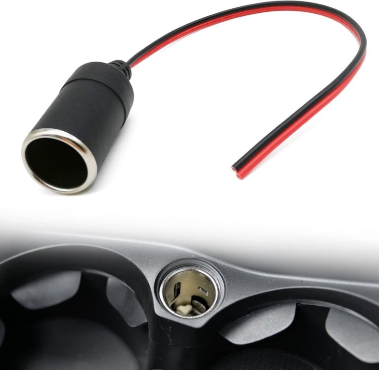

seanpatrickrice Posted October 17, 2024 Posted October 17, 2024 Can I cut the darn cigarette plug off and put some Anderson power poles on this so I can swap the radio from the car to an ammo can base station? Quote
1 amaff Posted October 17, 2024 Posted October 17, 2024 You CAN. But unless you'll never use the cigarette lighter plug, it might make sense to pick up a socket adapter and wire that to the Anderson connector so you can preserve the stock wiring. If you never use and never plan to use the "damn" cigarette plug, then yeah go nuts. wayoverthere 1 Quote
1 SteveShannon Posted October 17, 2024 Posted October 17, 2024 12 hours ago, seanpatrickrice said: Can I cut the darn cigarette plug off and put some Anderson power poles on this so I can swap the radio from the car to an ammo can base station? I did and I put power poles on the plug end as well so I can still use the cigarette lighter power. amaff and WRXB215 2 Quote

0 WRYS709 Posted October 18, 2024 Posted October 18, 2024 I purchased this from Powerwerx instead and kept the best of both worlds: amaff and wayoverthere 1 1 Quote
