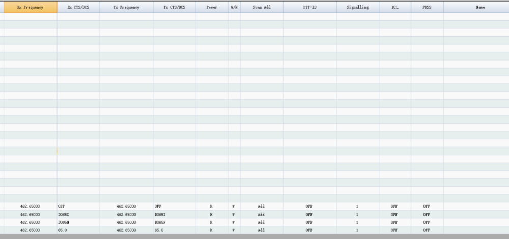

Shortarms Posted October 27, 2024 Author Report Posted October 27, 2024 this is the different ways i set it up to try Quote
SteveShannon Posted October 27, 2024 Report Posted October 27, 2024 1 minute ago, Shortarms said: this is the different ways i set it up to try Those all transmit on the wrong frequency. They must transmit on 467.650 MHz. GMRS repeaters receive on the 467 MHz frequencies and transmit on the 462 frequencies. That’s why I keep asking what channel you’re on. If you’re using a GMRS certified radio there are repeater specific channels (either 23-30 or sometimes RP15-RP22) that automatically adjust the transmit and receive frequencies. wayoverthere, amaff, Shortarms and 1 other 3 1 Quote

SteveShannon Posted October 27, 2024 Report Posted October 27, 2024 1 minute ago, Shortarms said: back to reprograming As of right now it's not a certified GMRS radio. You explained it great That’s okay that it’s not certified. Lots of people use non-certified radios. I’m not gonna point fingers. There are two ways to program the right transmit frequency. One is to simply insert the two different frequencies into the RX frequency and TX frequency columns if the software accepts that. The other is to insert the RX frequency into that column and then insert an offset frequency of 5.000 MHz into the offset column and hopefully the software will add the offset to the RX frequency and put the right frequency in the TX frequency column. WRHS218 and Shortarms 2 Quote
SteveShannon Posted October 27, 2024 Report Posted October 27, 2024 By the way, your third row has the right setting for DPL. D065N WRHS218 and Shortarms 2 Quote
