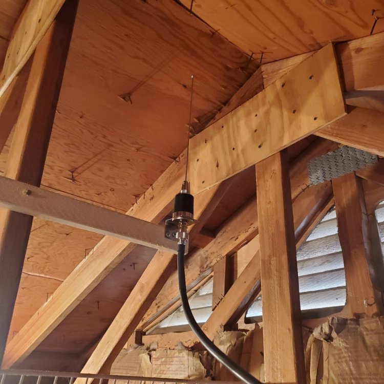

I'm running a non-ground Laird mobile antenna tuned for 465 Mhz that I placed in my attic and ran a LMR400 cable approx. 32 feet to one of my base station radios. I can hit all the repeaters that are within range of my location.

Very nice!  Yeah that might be an option for me too.  Thank you, second time I’ve heard of the Laird antennas.

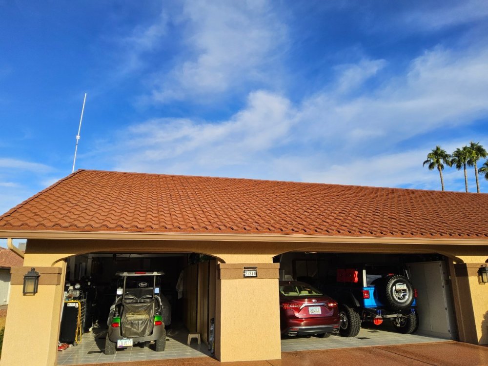

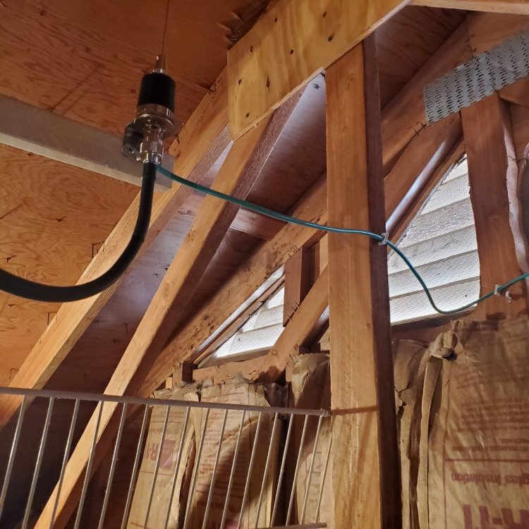

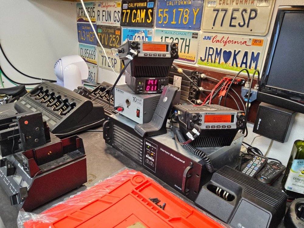

As I previously posted, I operate two base stations in addition to my repeater station. One of my base stations is connected to an antenna I placed in the attic above my shop/garage. The other base station is connected to another non-groundplane Laird B4502N and placed in the window of my shop. Both antennae work very well and will hit just about every repeater within a reasonable range that can see the other antenna. I have no complaints on the coverage.
Oh, by the way, my roof comprises of metal roof tiles.

Excellent feedback, thank you kindly!
