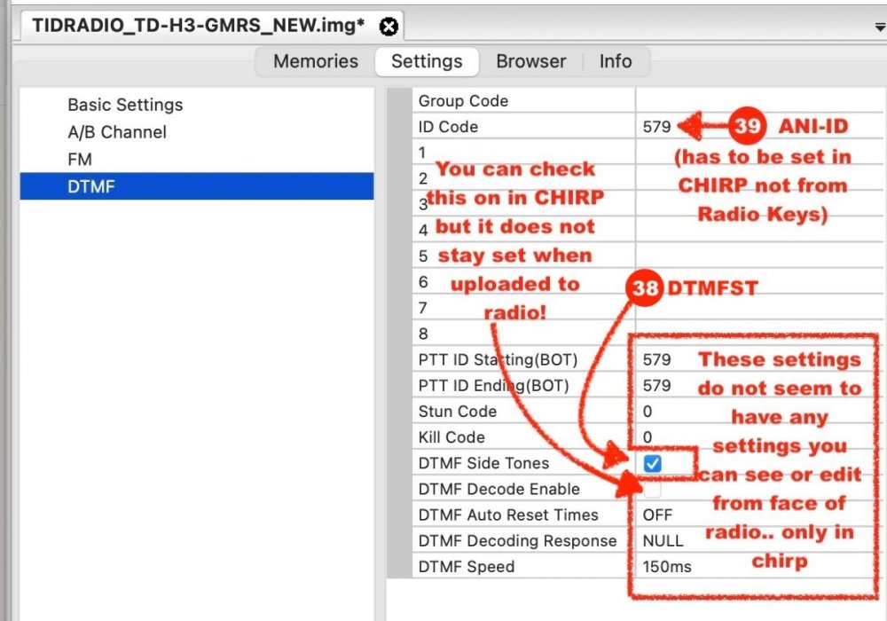

So here are some things I have found out about menu times 37 (PTT ID) and 39 (ANI-ID):
(screenshots and descriptions are in CHIRP)
  1. MOST IMPORTANTLY ... Neither setting seems to actually send any ID to other TD-H3 radios... nor does it seem to work sending to other radios like Motorola ones that have this ability. So basically all of this is pointless except for knowing it.
  2. Menu item 37 (red circle with number 37) shows in the Memories tab and applies to eahc memory slot / "Channel" individually, so you can turn it to BOT (beginning of transmit) EOF (End of Transmit), BOTH or OFF differently on every memory slot you have saved.
  3. Menu Item 39 (red circle with number 39) shows up in the  SETTINGS Tab and DTMF subtab . as ID CODE. Seems to apply to whole radio not per memory slot.
  4. Menu Item 38 (red circle with number 38) shows in the  SETTINGS Tab and DTMF subtab as DTMF SIDE TONES and is a true false checkbox.. on or off. (not really related to the PTT ID.. Separate function that DOES work if you hi the * key, type in a code and hit PTT it will send tones for the characters audibly to the other radio) This turns on or off the sending radio's play back of the audio tones of the code. off it is silent for the sender but comes in on the transmission... on it plays audibly for the sender on clicking the PTT and also transmits the audible tones. - but I know no real use for this in GMRS except maybe of old ol repeaters that use this to be controlled by audible tone codes.
  5. There are other settings below in the  SETTINGS Tab and DTMF subtab ( in CHIRP) which also seem to apply to the PTT id - but also do not seem to change anything, make anything work, or show up on the radio's own settings menu anywhere.
  6. The DTMF DECODE ENABLE  can be checked and unchecked in CHIRP.. but will not save to the radio when uploaded... it always is UNCHECKED when you read it back in to chirp.
    So after all that... it seems to me that 37 and 39 and the other settings that only show in chirp are "vestigial organs" (like the appendix in your body) left over and not used elements which are reserved for future or don't actually do anything useful anymore.
    I would love to be proven wrong if anyone does know how to make this PTT id thing work universally or even just between two Tidradio units.. but it does not seem liike they really do anything.
    Like I mentioned above in point number 4.. menu 38 does control if you hear the DTMF codes you can enter using the * key... on it will audibly play them on the sending radio and the receiving... off will make it silent to the sender but transmitted to the receiver.

Bad news...  the ANI-ID and PTT-ID are worthless on most amateur and GMRS radios (including the TD-H3) unless you have a standalone DTMF decoder.  There is no decoder, built-in or otherwise, that will display the ID on the screen of the radio.  So, unless you like hearing sounds like someone dialing a touch tone phone every time you transmit, don't waste your time.
