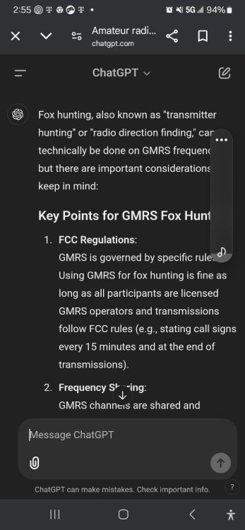

WSFL951 Posted December 3, 2024 Author Report Posted December 3, 2024 ChatGPT says it is ok to do it. SteveShannon, FishinGary and aiden702 3 Quote
SteveShannon Posted December 3, 2024 Report Posted December 3, 2024 7 minutes ago, WSFL951 said: ChatGPT says it is ok to do it. The second thing with AI answers is that they are drawn from the “collective wisdom of the internet.” You might not have asked correctly. The first is that AI has no authority to answer the question. But go ahead and trust it. Here’s an example: Davichko5650 1 Quote
WSFL951 Posted December 3, 2024 Author Report Posted December 3, 2024 (edited) 5 minutes ago, SteveShannon said: The second thing with AI answers is that they are drawn from the “collective wisdom of the internet.” You might not have asked correctly. The first is that AI has no authority to answer the question. But go ahead and trust it. Here’s an example: Gemini says too! Aaaaa! Edited December 3, 2024 by WSFL951 Davichko5650 1 Quote
