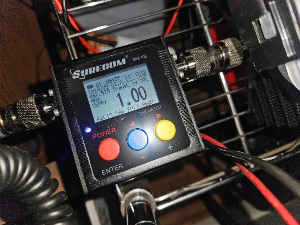

OldJunk2 Posted December 25, 2024 Author Report Posted December 25, 2024 On 12/25/2024 at 1:47 AM, OffRoaderX said: I assume you mean the dummy load AND your power meter? or are you relying on what the internal meter of the radio says (if it has one?) Expand Dummy load and sure com meter OffRoaderX 1 Quote

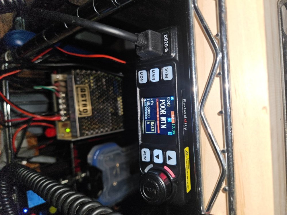

LeoG Posted December 26, 2024 Report Posted December 26, 2024 On 12/24/2024 at 11:37 PM, SteveShannon said: Pardon the intrusion, Question 0: does the screen indicate the radio is transmitting when the PTT is pressed. Expand I know on my KGXS20G when the output went dead the radio still looked like it was transmitting. Only way I could tell was to put my watt meter on the output to find out it was zilch. SteveShannon and WRYZ926 2 Quote

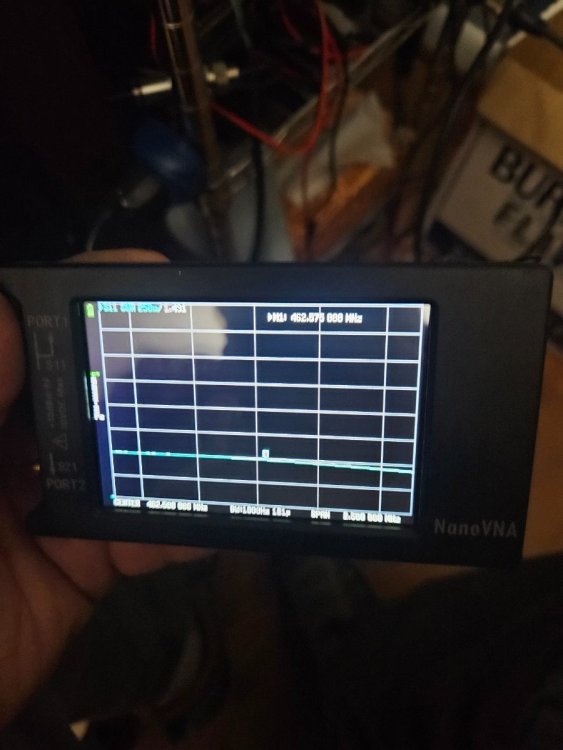

OldJunk2 Posted December 27, 2024 Author Report Posted December 27, 2024 Update: I'm a dummy. I had the TX tones entered into the RX of the programming. The radio is performing as good as a 20w should. I'm getting 15.5w on high with a SWR of 1.4 to 1 as tested with my NanoVNA SteveShannon 1 Quote
tcp2525 Posted December 27, 2024 Report Posted December 27, 2024 On 12/27/2024 at 8:33 PM, OldJunk2 said: Update: I'm a dummy. I had the TX tones entered into the RX of the programming. The radio is performing as good as a 20w should. I'm getting 15.5w on high with a SWR of 1.4 to 1 as tested with my NanoVNA Expand You did good, son. Generally, these issues are self correcting as the user gets more familiar with their radio. Now you will really enjoy the DB20 as its an amazingly good sub-$100 radio. OldJunk2 and SteveShannon 2 Quote
