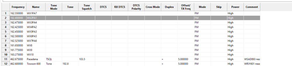

wsfr335 Posted January 7 Report Posted January 7 so programming my new radios with Chirp...not sure i have it right... in particular the Towson 600 one https://mygmrs.com/repeater/4281 Do i need to have permission from the owner? ( i did click on request but unsure if needed) this is what i have....
AdmiralCochrane Posted January 7 Report Posted January 7 No, the owner is very nice. You may use it. I have no trouble reaching it from the Annapolis area.
wsfr335 Posted January 7 Author Report Posted January 7 so i need to wait for owners permission? ie does he have to grant me access? Are my setting s right? esp re tone squelch and DTCS?
radiozip Posted January 7 Report Posted January 7 Repeater is open to use. https://www.howardcountyreact.org/gmrs PL tone looks good on the screenshot. WRUU653, SteveShannon and AdmiralCochrane 3
