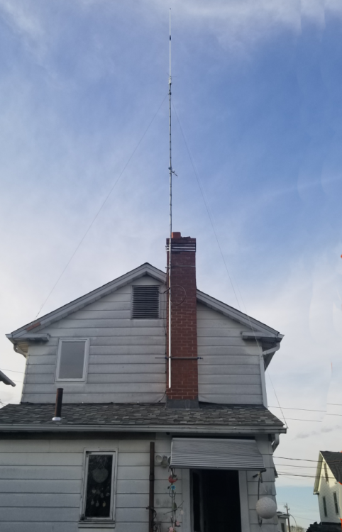

LeoG Posted January 30, 2025 Author Posted January 30, 2025 Oh ya, I know. I'll wait until I have access to the bucket truck. The antenna isn't actually easily accessible. This is an earlier picture. The mast holding hardware has been greatly increased. SteveShannon 1 Quote
