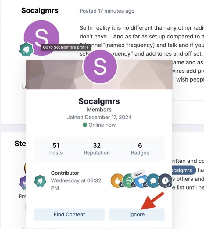

SteveShannon Posted February 22 Report Posted February 22 @Sonicgott, thanks for the well written and complete review. Also, if you’re new to the site, @Socalgmrs has a social problem that none of us understand. Apparently the only way he can feel self worth is to denigrate others and his most frequent targets are new members. The best way to deal with it is to simply place him on your ignore list until he bails out of this site like he did before. It should be a sticky somewhere for new members. Sonicgott, OffRoaderX, WSGC763 and 6 others 5 4 Quote
OffRoaderX Posted February 22 Report Posted February 22 More info: bignc, SteveShannon, Sonicgott and 2 others 3 1 1 Quote
