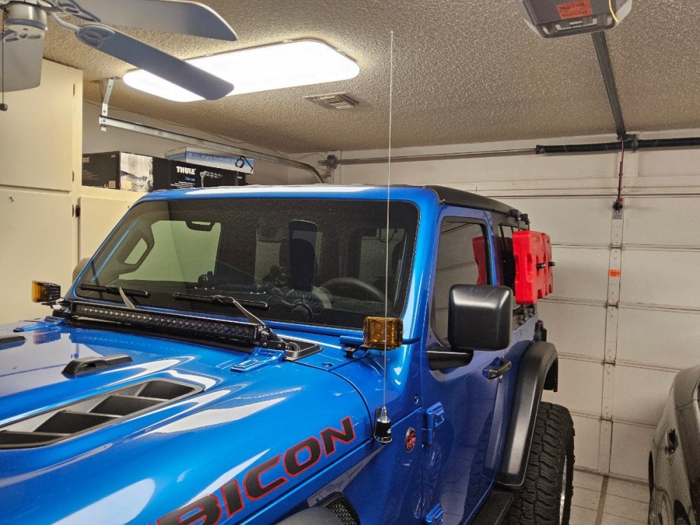

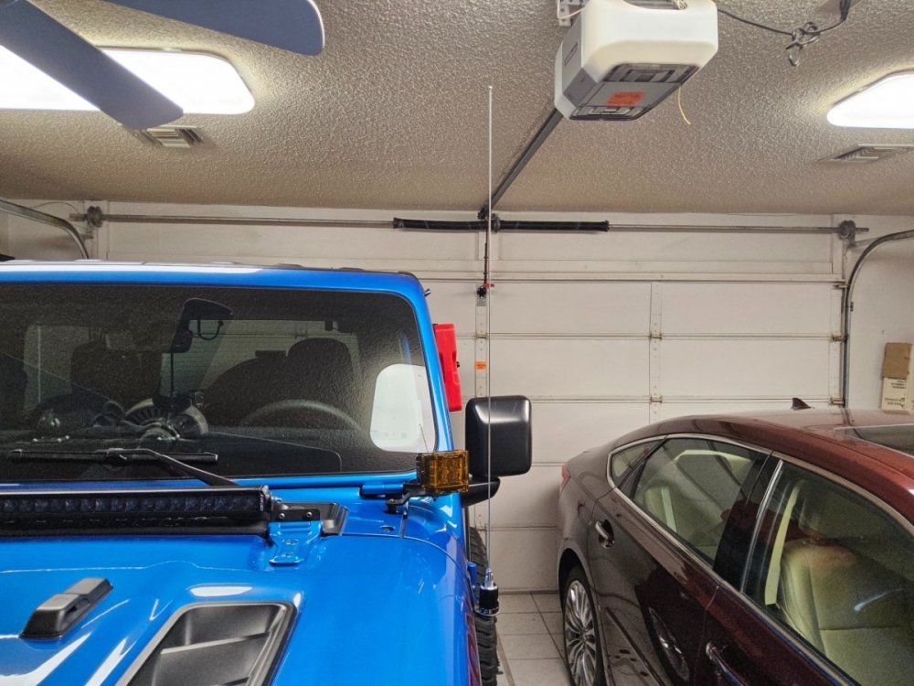

This is what I use for my VHF antenna. The antenna is a Laird non-groundplane antenna. The side bracket is a Rugged Radios bracket for Jeeps.  You can substitute the VHF antenna for either a Laird UHF or a Midland MXTA26 antenna. If you're just needing an antenna for GMRS freqs, go with the Midland MXTA26 antenna.

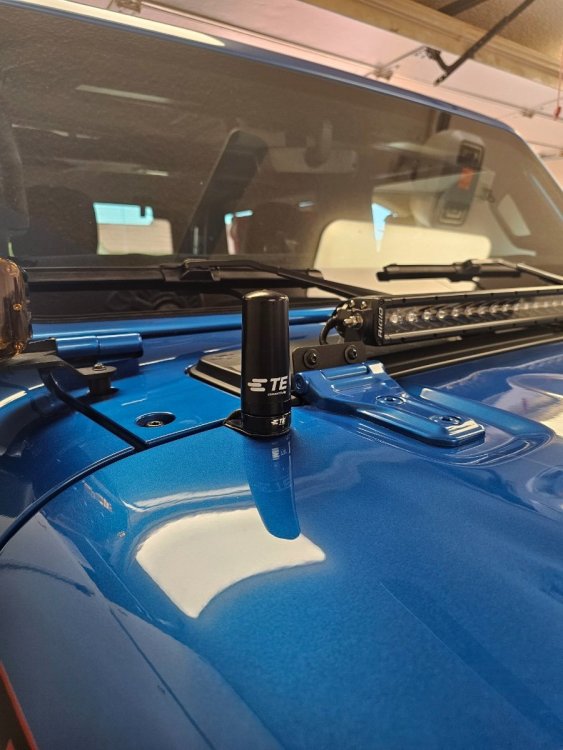

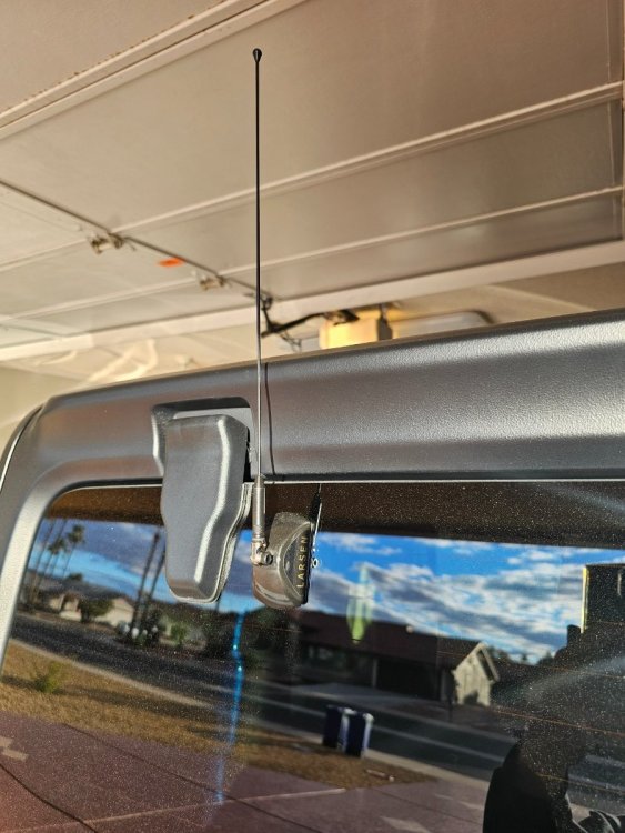

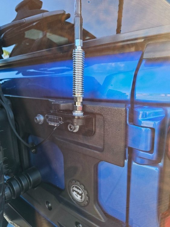

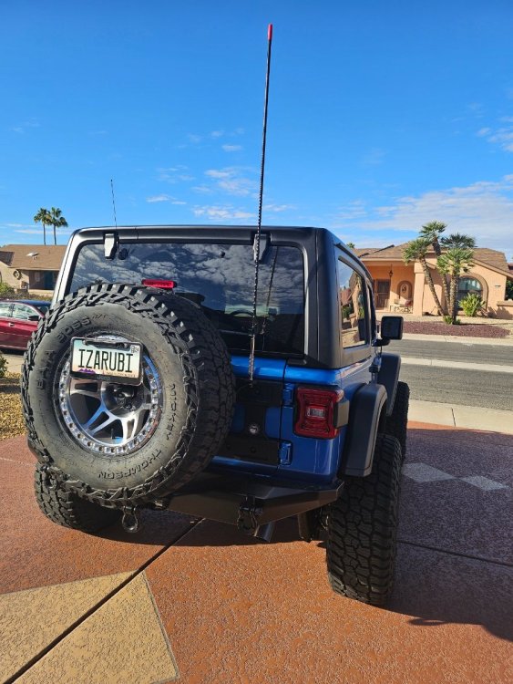

I have four radios in my 23 Wrangler Rubi 2 Dr. For my CB Radio, I use a Firestik II antenna off the rear tailgate hinge. Also, I run with a VHF radio and I use a Laird non-groundplane antenna hanging off the driver's side front cowl, and two UHF radios, one analog for GMRS and other analog frequencies, and one digital UHF radio for my radio club digital radio system soon to be statewide. The digital radio antenna is mounted on the hood with a lip-mount and the GMRS analog UHF radio, I use a Glass-Mount antenna mounted on the rear glass.
