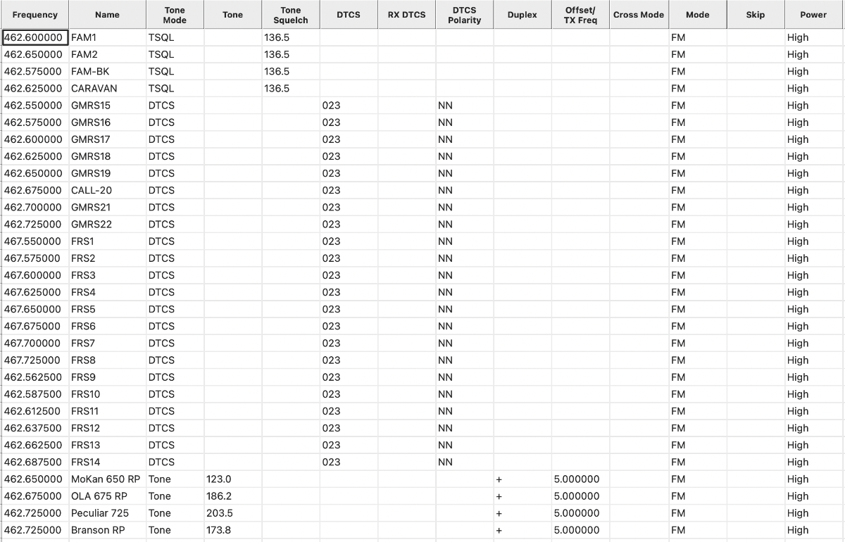

I don't know if it's right or wrong, but I have.....questions. Why are there DTC tones on every "FRS" channel? If you're trying to keep to the GRMS rules, your transmit power is wrong on 8-14. Why are GMRS 17 and 19 labeled as FAM1 & 2? The order seems to be kinda all over the place but if that's what you were going for, and the radios you're trying to talk to are set up similarly, it CAN work. It just seems a bit all over the place, without knowing the logic behind it (IE: did you copy someone else's cockamamie config blindly? Or is it set up that way on purpose?)

I just got my GMRS license and i'm unsure if i've set my handheld up correctly. I have a Baeofeng UV5RM and used CHIRP to setup my channels. I'd like to know if I set this up correctly, and are there any pro tips a new guys should know. Thanks! Baofeng Channel List 8.23.25.img

Welcome. Sounds like you’re doing everything right.
