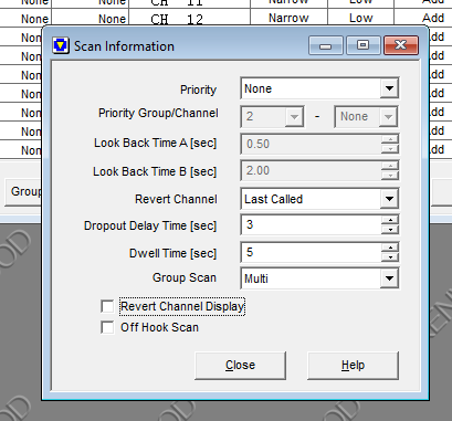

Make sure to check/enable “off hook scan” otherwise it wont scan unless the mic is grounded to a metal mic hanger.

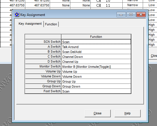

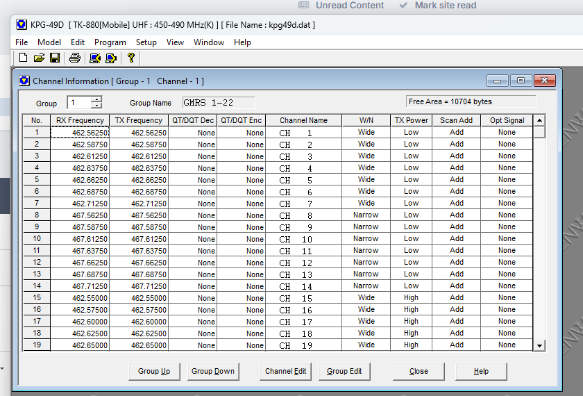

Slowly have been learning to program my TK880 v1. I've got it mostly ready to go, all my GMRS channels and repeaters are programmed in. I'm running the latest firmware E4B3. I cannot for the life of me, figure out how to get the radio to scan through any channels. I have them all set to scan add. I have the scan key set to scan and the B Switch set to scn add/del. On the radio if I hit the scan button it just beeps and nothing happens. I don't get the little scan icon to pop up.
Actually I figured it out. You have to click the check box in the KPG software under optional features 2 called "Firmware Programming". Then write it to the radio. Then reboot holding the scan button and it will show the program menu to flash the firmware. Still can't seem to get my scan functionality working but I was able to update the firmware.

WSGI699 Were you ever able to figure out how to get the radio into program mode? Mine is doing the same thing. I can program it with KPG-49G but when I look online I'm missing features and the scan functionality doesnt work on mine. I can't even look up the firmware/baud. When I try using the above hex file LSscott shared FPro doesnt do anything. It "writes" but nothing happens on the radio.
