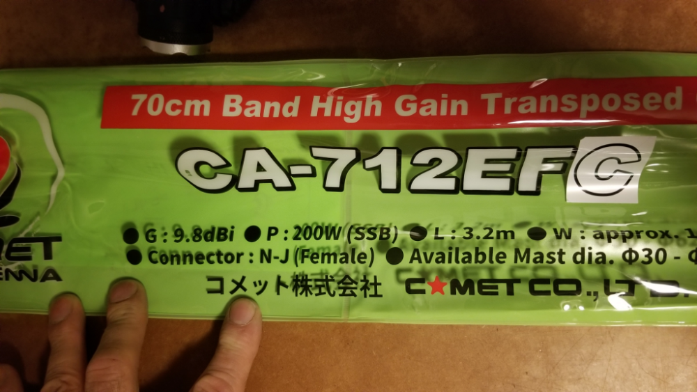

LeoG Posted May 6 Report Posted May 6 I have the 712efc and the paperwork that came with it claims 9.8dBi. It's on the bag and in the paperwork so that's what I assume it is. So it's even bigger than 7.2 Quote
