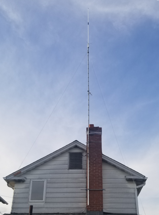

There's a company that makes custom lengths of 7/8" heliax to order. Their prices seem pretty reasonable when I looked, but might still break your budget.
I'd go with the best cable you can get for the main run. Use whatever connectors the antenna uses (no adapters at the antenna end). Then a lightning protector. Then 400 ultraflex to get into the house and to a base station, or a single adapter to a skinny coax with the matching ultraflex on one end and SMA-F (usually) to connect to a hand-held being used as a base station. My preference for outdoor connectors (and in general, actually) is N connectors. I wrap the completed, tested connector assembly in Scotch 88 electrical tape and then slide one of the heat-shrink tubes from a local Home Depot/etc. underground splice kit onto it and shrink it. That makes it watertight (you don't want water getting into your nice new cable). The heat shrink tubing and hot melt glue inside it will make a watertight seal, and the electrical tape means the connectors won't get gunked up with glue if you ever have to go into that connection again.
This way you can upgrade your antenna at a later time without worrying about your cabling robbing power.
If you use a commercial installer (not on your budget) you should get a PDF or hardcopy of an SWR sweep across your intended working range. Otherwise you can probably find someone with a SW-102 or similar to give you power and SWR readings.
At the other end of the spectrum (pun intended) you can go all-out. My plan is 7/8" heliax from the lightning protector to a 20' mast on the roof, then a DB420-B (if the price ever becomes sane again - prices have tripled and Andrew is quoting 4-5 month lead time) antenna . The ground field is eight 8' long ground rods 16' apart connected with a continuous length of #4 copper and bonded to the power entrance. From the lighting protector to the repeater inside the house, I'll be using 400-class ultraflex.
If you were in the NYC area, I'd give you a short reel of LMR600 - I end up with anywhere from 50' to a few hundred feet I can't use, on giant (table-size) reels. This is stuff left over from other RF work where LMR600 is preferable. That stuff is so thick and stiff that I made a walking stick out of an N connector on a length of LMR600. It was the end of the day and a storm was rolling in, so I just put connectors on the too-long cables to connect them to the protector bank. 2 days later I came back and cut the lengths down to the proper size, hence the leftover.
