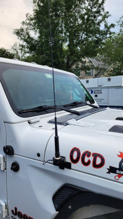

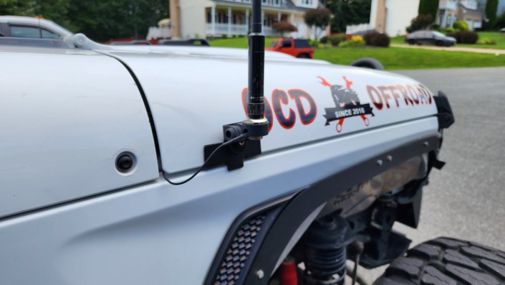

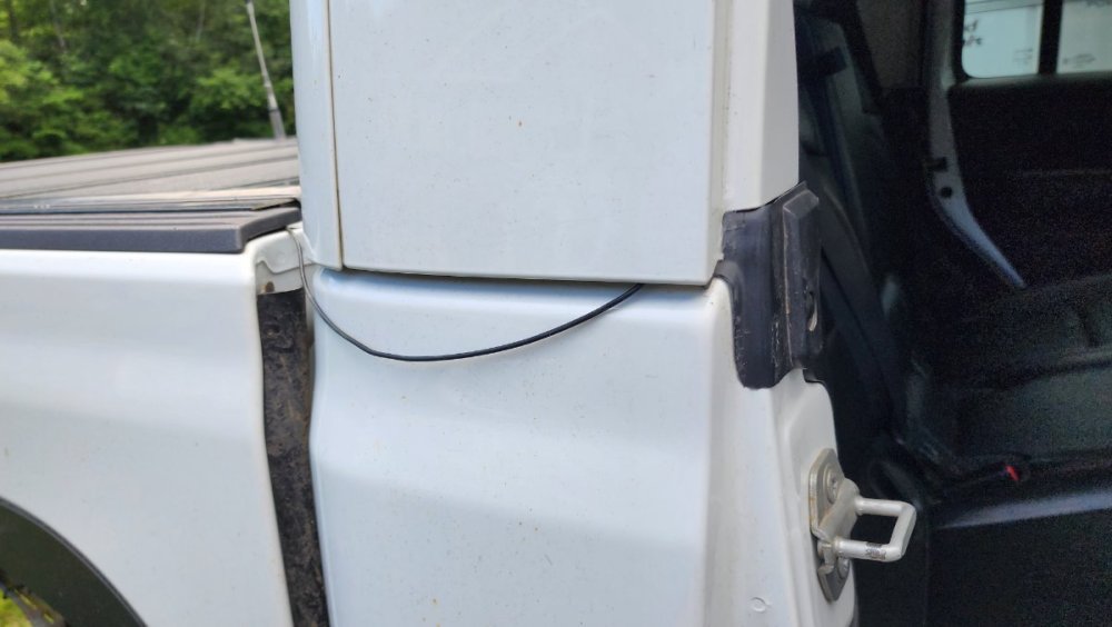

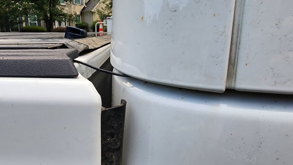

marcspaz Posted June 29, 2025 Posted June 29, 2025 If you are mounting an antenna that large, i would drill a hole in the top of the bed rail over the tail light and hard-mount a UHF mount. (Or NMO). The only other option would be to use a lip mount on the hood. Something like this... ot the Diamond version. https://www.cometantenna.com/product/coment-hd-5m-heavy-duty-rs-840-lip-mount-w-dlx-166-coax-gold-uhf-conns/ I'll take a couple pictures of mine in about an hour and show you what I have (both) for GMRS and Amateur Radio SteveShannon 1 Quote

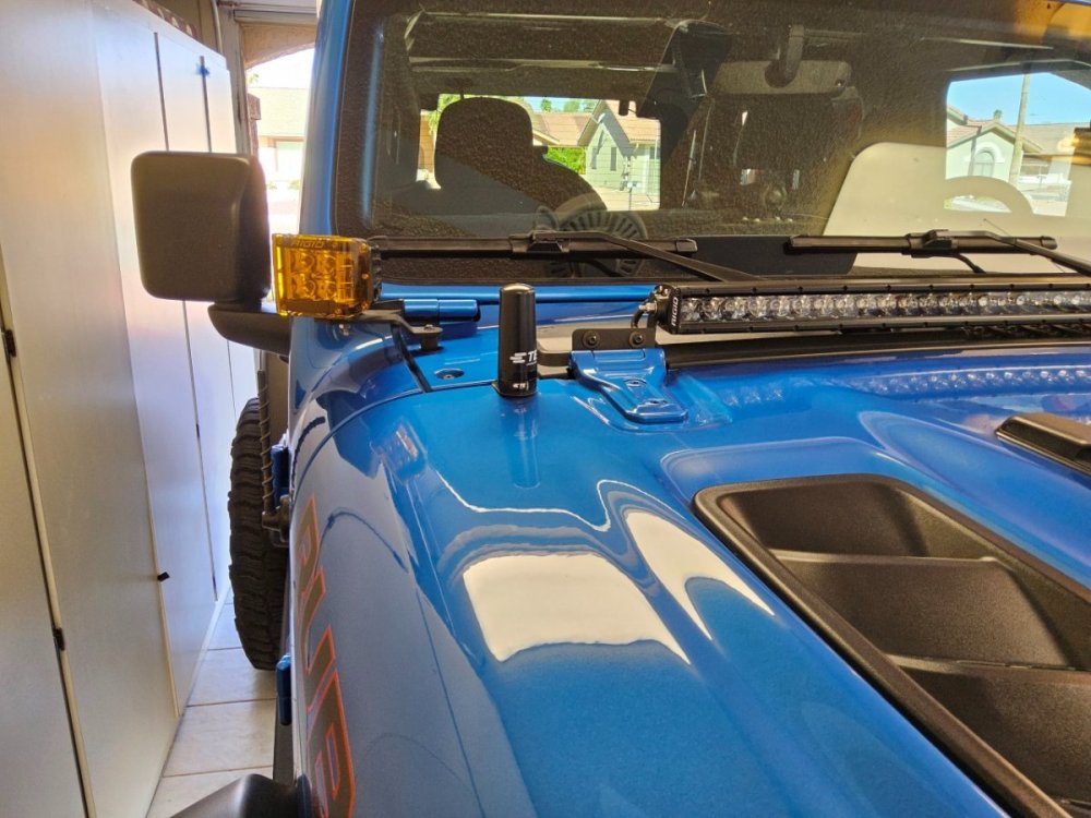

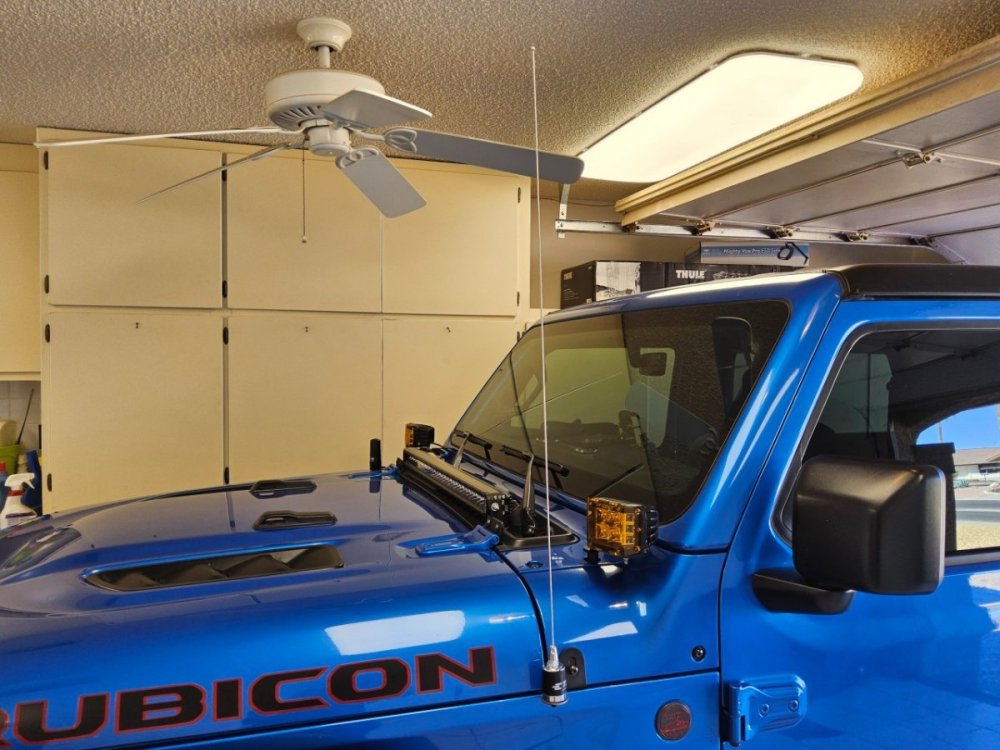

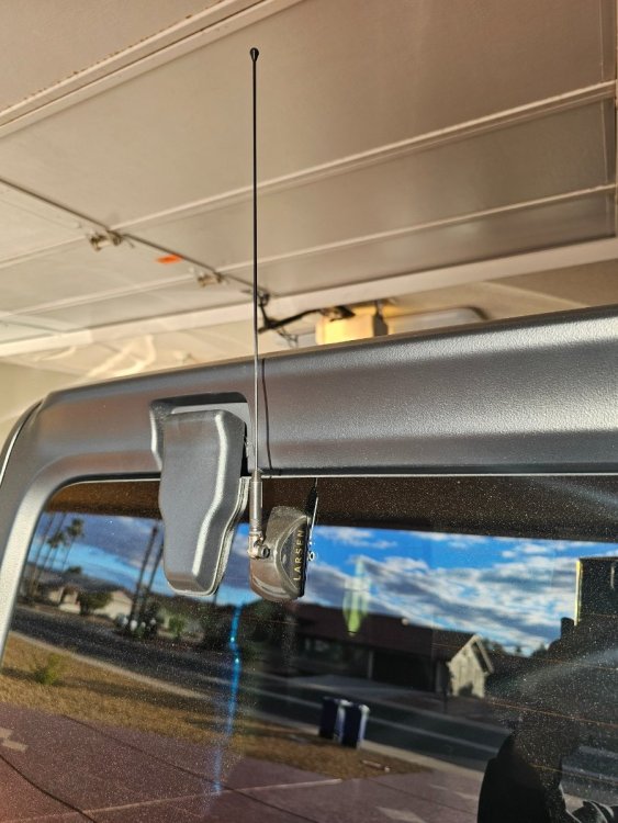

nokones Posted June 29, 2025 Posted June 29, 2025 19 hours ago, WRTC928 said: What's a good antenna mount for the 2025 Jeep Gladiator Mojave? IIRC, the hood is aluminum, so it should provide a decent ground plane, but the way the hood wraps down toward the fender makes me wonder if a regular hood lip mount will work. Does it need something special? Is a hood lip mount even the best way to go? I'm planning to put a 52" antenna on it, so it needs to be sturdy. Here's three options for the Jeep. The lip mount on the hood is a Laird Lip-Mount and Phantom antenna, and does not need anything special. This Phantom antenna is used for UHF DMR. The mount on the driver's side near the A pillar is a Laird non- ground plane for VHF and the mount is a Rugged Radios mount. The glass-mount on the rear glass is a Larsen and used for UHF. I get great performance with the glass-mount antenna. All of these options can apply to the Gladiator. The Midland antennae are great if you are just transmitting on GMRS freqs. If you are transmitting on a mix of GMRS and Business Radio Service freqs use the Lairds and Larsen antennae, do not use any of the HAM crap stuff. gortex2 and SteveShannon 2 Quote

WRTC928 Posted June 29, 2025 Author Posted June 29, 2025 2 hours ago, nokones said: Here's three options for the Jeep. The lip mount on the hood is a Laird Lip-Mount and Phantom antenna, and does not need anything special. This Phantom antenna is used for UHF DMR. The mount on the driver's side near the A pillar is a Laird non- ground plane for VHF and the mount is a Rugged Radios mount. The glass-mount on the rear glass is a Larsen and used for UHF. I get great performance with the glass-mount antenna. All of these options can apply to the Gladiator. The Midland antennae are great if you are just transmitting on GMRS freqs. If you are transmitting on a mix of GMRS and Business Radio Service freqs use the Lairds and Larsen antennae, do use any of the HAM crap stuff. Those are all useful options. I'll show them to the owner. SteveShannon 1 Quote

marcspaz Posted June 29, 2025 Posted June 29, 2025 Couple quick pics. Ignore the body damage.. it my offroader. WRYZ926 and WRTC928 2 Quote

nokones Posted June 29, 2025 Posted June 29, 2025 1 hour ago, WRTC928 said: Those are all useful options. I'll show them to the owner. All three antennae shown are removable. The front two are on NMO mounts. Quote
