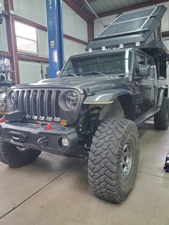

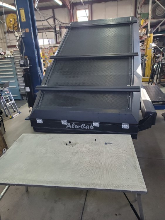

I have a Jeep Gladaitor with a AluCab canopy Camper with 2ea 200w solar panels.
They are mounted on 3 rails, rails are Alumnum as is the camper and frame work of the ridged panels.
I have a Midland MXT 575 and will be using this to talk to others on overlanding trips from desert to mountains.
I would like a antenna no taller than 18" and would like it mounted if possible on the middle rail or the rail closest to the cab. Note the Jeep tops are fiberglass so not mounting their..

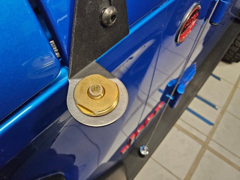

You will need to use two antennae, one for the 70cm freqs and one for GMRS. You should mount each antenna on the side of each cowl near the "A" Pillar using the Rugged Radios mounting brackets and NMO mounts. Don't use the cheap stuff get the Laird Mount and Cable from a reputable Radio Electronics Dealer. As for the GMRS antenna since it appears you are only concerned with GMRS for the trail, you should get thd Midland MXTA25 or the MXTA26.
Attached is a picture of my Highband VHF antenna on the side near the cowl and "A" Pillar. Also attached is a Laird Lip Mount NMO mount I use for my UHF DMR freqs. The Phantom antenna is a Laird.
Just make sure that the mounts have chassis ground continuity without the coax cable connected to the radio.

 I assume since the solar panels are mounted above the alumnum roof is the reason it will not work to provide a ground plane.

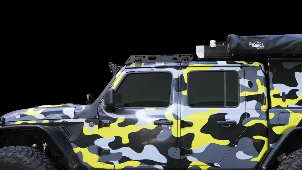

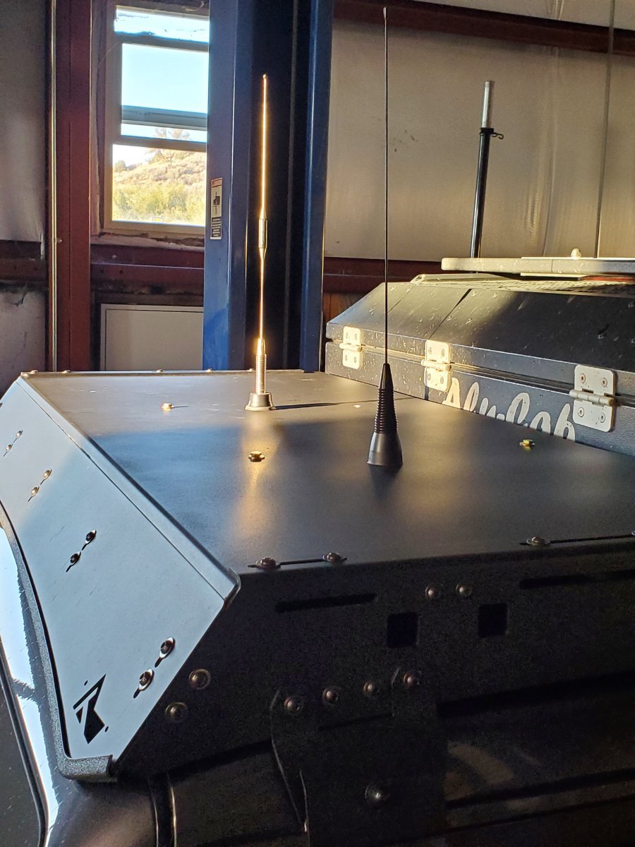

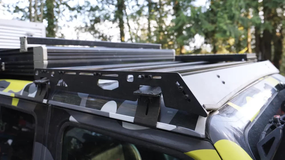

Looking at this one, Sherpa Moonlight shorty. I'll plate the bottom rack to creat a ground plane about 24x54+-.
If I go this way plate out of Alumnum or Steal? I'll powder coat either way.
Have everything made and parts installed, waiting for the local HAM expert to check all.
Parts I used:
 2ea Melowave NMO to UHF Antenna Mounting Stud
2ea Messi & Paoloni Hyperflex 5 Premium Pre-assembled Coax - UHF Male (PL259)
NMO2/70SH
EM Wave EM-M10003
