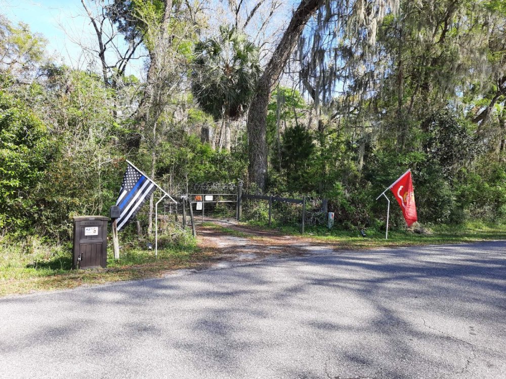

Mrsig Posted July 17 Report Posted July 17 30 foot tower & this is my main gate. Good luck getting in.... GreggInFL 1 Quote
