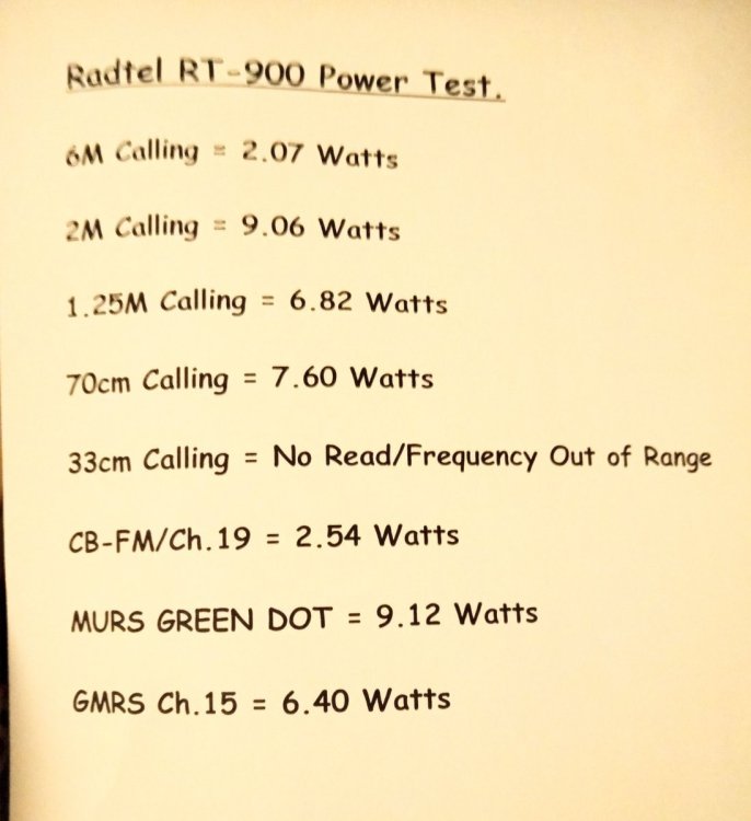

Lscott Posted August 22 Report Posted August 22 8 hours ago, TNFrank said: I have one and it WILL do 33cm/900MHz, trust me. You set it to "Super Mode" and you can do from 18MHz to 999MHz. It only says "Dual Band" on the web site but it'll do 10M, 6M, 2M, 1.25M, 70cm, 33cm, CB FM, MURS and GMRS and alot of other Frequencies in between. If you can put it on a scope and frequency counter to verify that. Then the next test is output power. That I expect to suck. Trying to design a tuned power amp stage to have that kind of bandwidth is going to cost a lot more than $25. I know many people thought their D878’s could do 1.25M since they could program in the frequencies. However the real results at the antenna port just wasn’t there to make it worth the trouble. WRXL702 1 Quote
TNFrank Posted August 22 Report Posted August 22 My Surecom will only test up to 525MHz so I can't get a power reading at 900MHz but I did test all the other frequencies. There's plenty of videos on YouTube about the RT-900 you can watch and I plan on doing one tomorrow to post to my channel. I'm also getting some properly tuned antennas for 900MHz to use because nothing I currently have is tuned for that frequency. Also, without actually getting one you can't just presume that it's junk. It's actually worked very well at 2M, 1.25M and 70cm hitting repeaters over 20 miles away with the Nagoya 320a antenna I have on it. I'd say pick one up and give it a try, what have you got to loose? At the most you've dropped $25 bucks on something that will work on several different bands and would be a good beater radio to keep in the truck or as a back up to your other radios. Quote
Lscott Posted August 22 Report Posted August 22 9 hours ago, TNFrank said: My Surecom will only test up to 525MHz so I can't get a power reading at 900MHz but I did test all the other frequencies. There's plenty of videos on YouTube about the RT-900 you can watch and I plan on doing one tomorrow to post to my channel. I'm also getting some properly tuned antennas for 900MHz to use because nothing I currently have is tuned for that frequency. Also, without actually getting one you can't just presume that it's junk. It's actually worked very well at 2M, 1.25M and 70cm hitting repeaters over 20 miles away with the Nagoya 320a antenna I have on it. I'd say pick one up and give it a try, what have you got to loose? At the most you've dropped $25 bucks on something that will work on several different bands and would be a good beater radio to keep in the truck or as a back up to your other radios. For $25 you won't get the performance you expect. There are other things you should look at such as RX sensitivity, de-sense, channel isolation, spectrum free from harmonics, spur response, frequency accuracy and stability etc. Most people don't have the equipment to do these kinds of tests. If you know somebody with a good quality commercial radio grade service monitor I would stick the radio on it and run some tests. Some decent used ones run around $1K plus used. I believe one of the members of this forum got a used one in this price range a while back specifically for testing his radios and repeaters. A few that can do auto tune up, radio calibration, and digital mode testing can run over $10K to $20K plus used. For example the cheap, $25, Baofeng UV-5R early version had dirty transmitters. They were multi-band radios. You could talk on several all at the same time! I'm not knocking your desire to do a video on the radio. But remember you give people the idea the radio is the best thing since sliced bread, people buy them because they're cheap, and now the local bands have issues with crappy signals on the air. UV-5R VHF Harmonics Test.pdf WRXL702 and PACNWComms 1 1 Quote

PACNWComms Posted Thursday at 01:33 PM Report Posted Thursday at 01:33 PM (edited) Any idea on actual output power in the 900 MHz band? I always scoff at the handhelds claiming 8 Watts, in a radio that size.....and when tested it is only 3-4 Watts and then drops off quickly to something a lot less than that. I like the displays and the layout of the radios though. Seem a lot like my Anytone 878 variant. Edited Thursday at 01:34 PM by PACNWComms Edited 9800 MHz band to 900 MHz band (I work in 800 MHz most of the time), fat fingered. Quote
