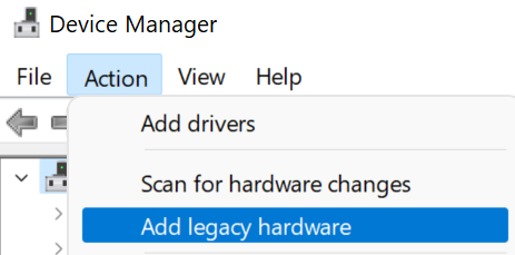

To add a COM Port, you can launch Device Manager, highlight your Computer Name at the top of the list, select Action menu and Add legacy hardware.
Follow the wizard to Install the hardware that I manually select from a list, choose Ports (COM & LPT), Standard and Communications Port. However, I would suspect this will not work with your device.

This from the Microsoft help site might help:
Hello, thank you for your reply!
