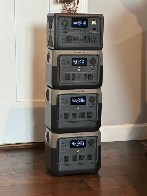

DominoDog Posted January 6, 2024 Report Posted January 6, 2024 The only problem I have with power stations like this is the amount of noise they put out. They are so buzzy. I have two Ecoflow River2 Pro's that I swap out for my camping setup. Use one while the other charges, etc. They put a loud buzz into the 12v power output that I can hear thru the audio on handhelds that are powered on while charging, and they put a loud AC inverter buzz on audio equipment if it has an amplifier. I'm not even going to test how noisy they'd be on a radio transmitter. For general use, they have been a game changer for camping and for keeping my tool batteries charged for work. But noisy for sensitive electronics. Far noisier than I expected them to be; the River 2 Pro is one of Ecoflow's flagship models. It's their biggest small one. Well, I'll say they are noiser than I *wanted* them to be. But it has to be very difficult to make something like that quiet. The best thing I've found for backup power is just a battery. You can use the solar power station to charge a good backup battery, but I don't know if I would use the power station to run the transmitter directly, unless I just had to. Sab02r, BoxCar, WRNN959 and 1 other 4 Quote

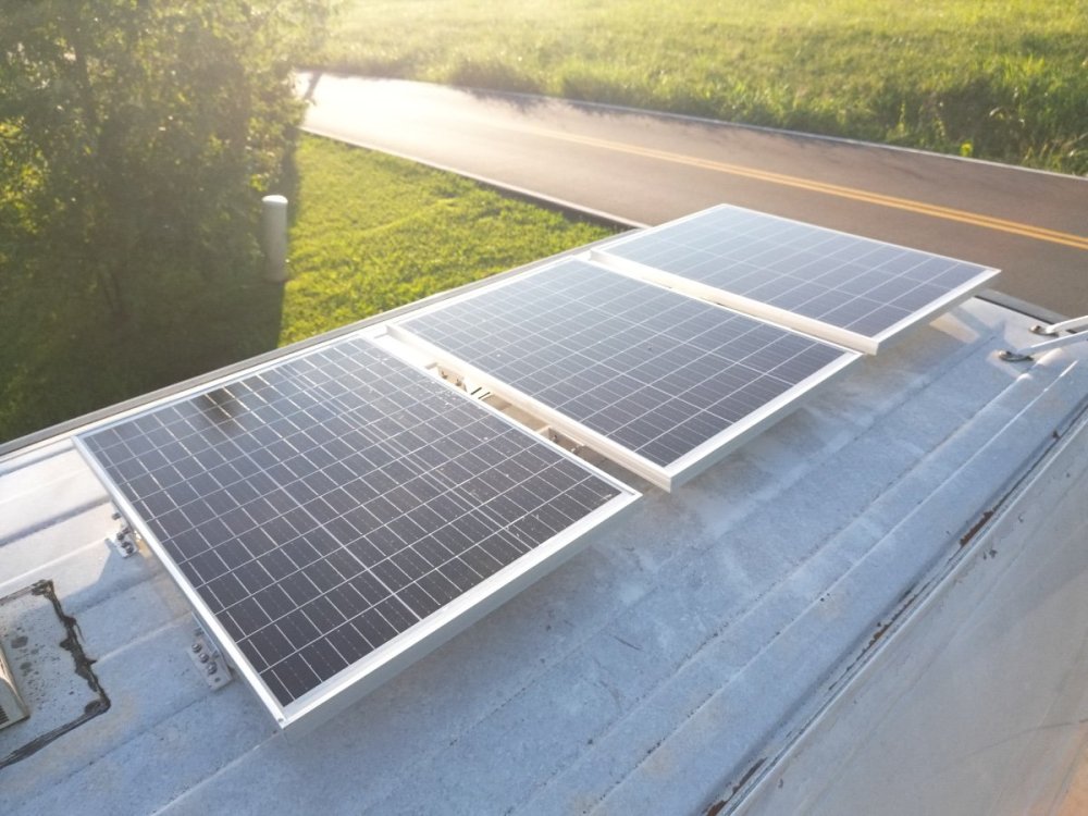

WRNN959 Posted January 7, 2024 Report Posted January 7, 2024 Regarding the "radio shed", the south facing slope of the roof could accommodate one to twelve 200w rigid panels like on our camper. Not sure I need to go that far but a single panel dedicated to charge a modest battery bank for the comms system would be a no-brainer. Sab02r, WRUU653, SteveShannon and 1 other 4 Quote

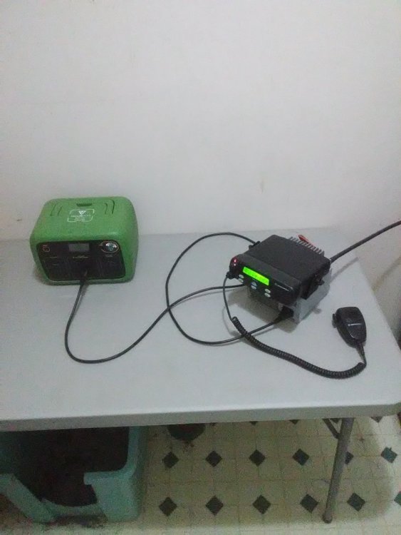

WRTL946 Posted January 10, 2024 Report Posted January 10, 2024 I haven't had any issues with noise in my transmissions when using my Bluetti solar system. I don't use the 12v socket, I use it's pure sine inverter. But, that's me and my setup. WRNN959 1 Quote

DominoDog Posted January 10, 2024 Report Posted January 10, 2024 I have a little Bluetti EB3A and contrary to popular opinion, it has done pretty well for me. If you can work it within its limitations, it does really well. I haven't checked it for noisy output. That might be my go to unit for radios, if it ends up being quiet and clean. I can't say anything bad about Bluetti. I wouldn't even have an Ecoflow unit if I didn't fry my own Bluetti by accidentally giving it too much voltage when experimenting with panels. Dumb mistake. But they chose to repair it for free and ship it both ways on their dime. I can't complain at all. I have definitely watched a couple of Hobotech's videos. I like the personality he puts into the videos. WRNN959 and Sab02r 2 Quote
