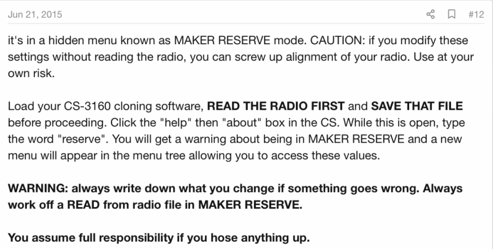

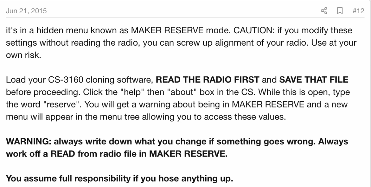

Lscott Posted November 20, 2025 Posted November 20, 2025 Oh, there is a hidden menu in the programming software that allows you to change a bunch of specific items in the radio. The procedure for the CS3160 is the same for the CSF2000. Some other Icom radios might have this hidden menu as well. onemanparty 1 Quote
