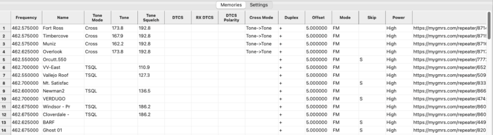

WSBB368 Posted March 30 Report Share Posted March 30 I just exported the repeater list for california "chirp" and imported it in chirp i noticed that alot of repeaters have the "s" skip function on them are these repeaters not working? or permission only? was wondering why they had the "s" function see attached Quote Link to comment Share on other sites More sharing options...
OffRoaderX Posted March 30 Report Share Posted March 30 "Skip" means that if you enabled scanning on your radio those channels will be "skipped" during the scan. As to why it's there or who put it there: Nobody can answer that, and it does not matter WRHS218 and WSBB368 2 Quote Link to comment Share on other sites More sharing options...
back4more70 Posted March 30 Report Share Posted March 30 Probably best to avoid the one named BARF... Quote Link to comment Share on other sites More sharing options...

rdunajewski Posted April 1 Report Share Posted April 1 They are skipped during scan by default since there's no output tone. Any activity on the channel will cause the scan to stop and what you're hearing may or may not be that repeater anyway. This way, if you get the tone information, you already have the channel programmed, you can set up the tones and add to the scan list, and you're off to the races. WRUU653, WSBB368 and SteveShannon 3 Quote Link to comment Share on other sites More sharing options...
