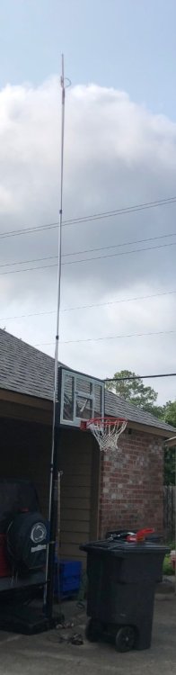

You might be able to do something with a long painter’s pole.  I’m using a 24’ one with a j-pole antenna (putting that basketball base to good use).
This was only a proof of concept test but it definitely helped me get better distance.

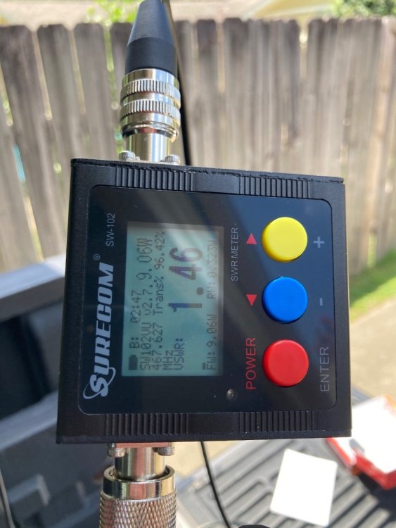

How much power are you seeing?
Per the meter, i frequently see 8-9W.  The higher number is with ta Midland ghost and the lower is with the long rubber duck.
Edited by WRDJ205
Changed values and added pics
