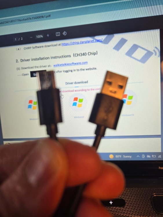

I'm having issues with "USB device not recognized" when using the USB cable provided with the radio.   I assume the cable used to charge the radio is the same cable I use to program the radio using the USB port on the side.   I didn't see any other cables included in the radio package.   Am I missing the correct cable for I programming?

The supplied USB-C cable will work for data transfer on the TID programming software and CHIRP.  Make sure it is securely inserted into the USB C port on the right side of the radio under the rubber cover.  If it's not pushed all the way in it will not work.

That happens if you haven’t installed the correct driver before plugging in the USB cable.
Thanks.  It looks like I get the driver from the Tidradio website but need to log in to their website.  Is it possible to get the driver without logging in?

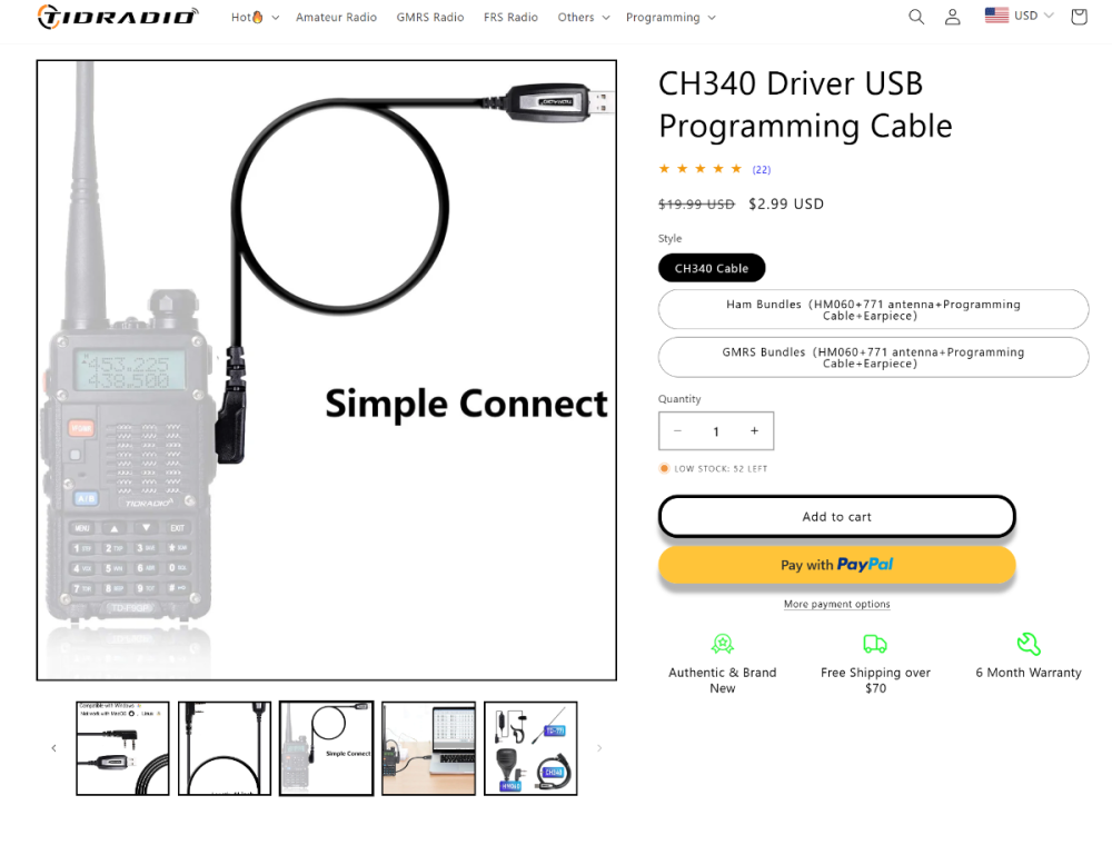

Pretty sure that is for charging only and that radio uses a k1 programming cable like many other radios.  You usually have to order a cable separate since you would not want to have to pay for a cable with every radio.  You could own 10radios and you only need one cable. Keeps the price down.

FYI, If you have, or plan to have, different radio brands consider a look at the Mirkit Universal Programming cable set --as it works for multiple radio brands and is plug-and-play.   I used it on Baofeng and Retevis = very nice and easy.
https://www.amazon.com/MIRKIT-Baofeng-Programming-Compatible-Radios/dp/B09LD2HCZV/ref=sr_1_5?s=electronics&sr=1-5

They say you can program by USB-c.  I haven't had any success doing it and I bought the Kenwood plug/adapter.  I've had no issues with programming the radio using that setup.  There is a USB port on the side along with the Kenwood outlet.  The one on the bottom is to charge the battery.  I just use the Tidradio CPS to program my H3 radios along with the Odmaster.  I've also upgraded to 140625 and now 140702 firmware using their IAP app.  The firmware before 140625 had an issue with blanking out repeater signals for about 2 seconds on the 1st part of the receive after unkeying.
