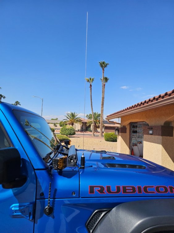

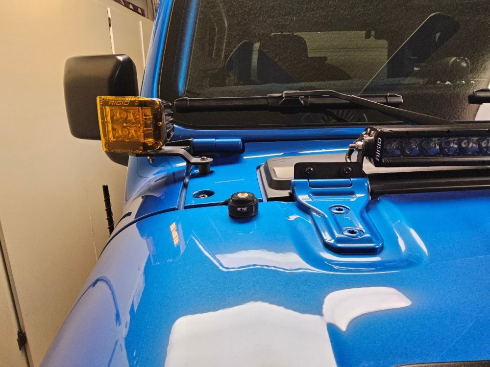

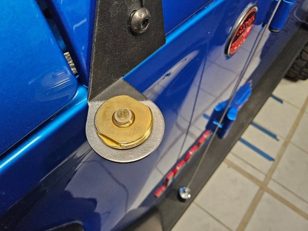

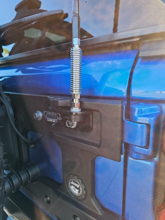

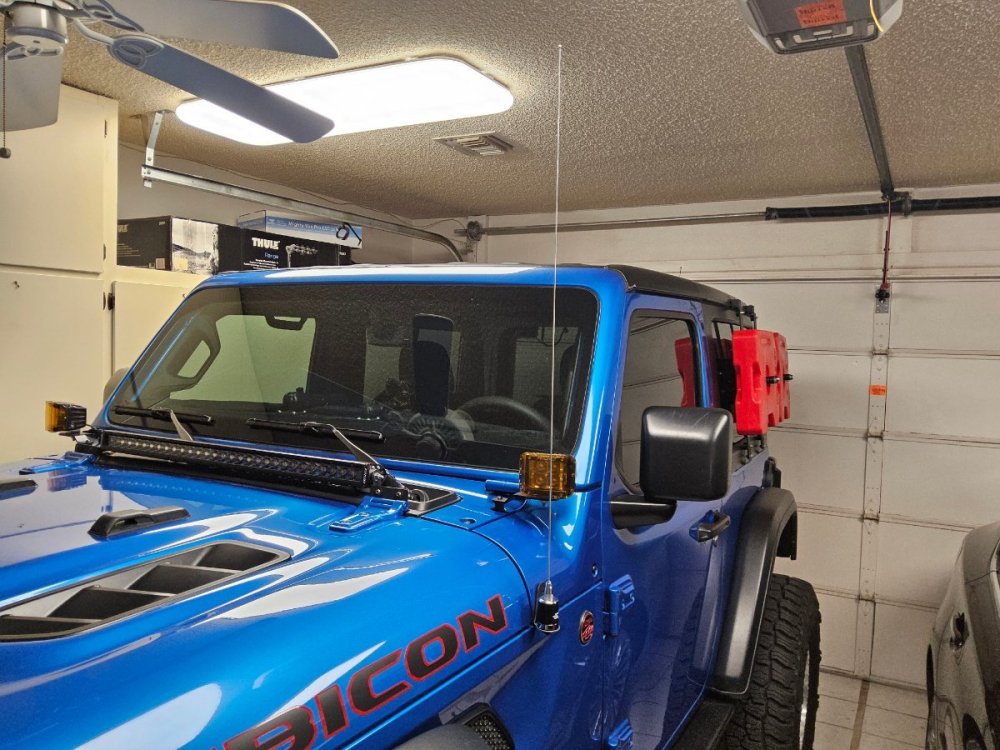

There may be a couple of options like the Jeep has, if the Bronco can accommodate them, but, you need to think about using the Midland MXTA26 GMRS antenna. This antenna usually will give you the best VSWRs right out of the box on both the 462/467 GMRS freqs. and has one of the best results for GMRS freqs.  Another good antenna is the Laird B4505N (5 dB non-groundplane), but it will need to be tuned/trimmed.
Here are a couple examples on how to mount antennae:
