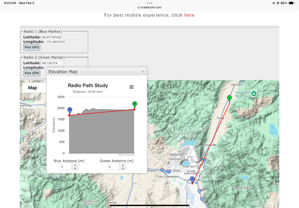

Here is the plot for the big repeater I can hit on 5w. I am the blue pin. But this repeater has huge range. We heard a guy last weekend hit it with a 7 element yagi and 50watts iirc from N. Las Vegas, about 110 miles away!! He was scratchy, but readable.

It’s a very good tool, but while line of sight is great for vhf and uhf radio work, it’s not absolute.  For instance, here’s how it analyzed the path between my friend’s house and my cabin.  He and I can communicate via 2 meter simplex, but according to the chart we shouldn’t expect to:

You have your antennas set to 1 meter.  Are you both HTs?
I also use the Radio Mobile Online calculator.  It's much more complex but gives more information.  You do have to figure out how to set it up.  Keep the required reliability up toward the high end or it'll tell you everything will work.  I keep mine at 99.85% and it's reasonably accurate.  It doesn't account for trees which can be a major blockage of UHF so you have to think about that yourself.  You have to sign up for an account to use it.

Mine is. His is probably 7 meters above ground, but if you look at the topography there are probably 10 kilometers of intervening granite that is as much as 500 feet higher than the “line of sight“ between my cabin and his house.
  On 2/6/2025 at 8:02 PM, LeoG said:
Yep, just noticed it's 300' of mountains.
Maybe try it in Radio Mobile, they have a frequency input that might show you it can reach.
Expand
I know it reaches. My point was simply that if you looked at nothing other that the line of sight tool in scadacore you wouldn’t expect to be able to communicate on either VHF or UHF.

I think it probably is.
20 watts brings the signal down to 0.07µV from 0.11µV
Don't know what the sensitivity of those radios are but this program seems to say you can't communicate either....  And yet.
