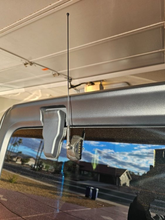

nokones Posted February 8 Report Posted February 8 I have the Larsen Glassmount on the rear glass of my 23 Wrangler Rubi 2 Dr. and I have had and continue to have great success with it for my UHF radio. I can hit repeaters well over 50+ miles and I can definitely hear FRS traffic at least the 5 miles away as a desert buzzard would fly. I really don't have a need to talk simplex except when I am wheeling on the Trail and those distances normally don't exceed a mile, but on one occasion I did communicate simplex and I estimate the distance with a Midland MXT275 that is a 15 watt mobile clearly, about 10 and maybe 15 miles away. My VSWR on 467 Megs is 1.5 - 1.6:1 and on 462 Megs the VSWR is a good 1.2:1 and that is without any trimming. I decided to leave the antenna as is and not trim it. I personally don't see anything wrong with using a glassmount antenna. Decades ago, I have had great success with the Antenna Specialist Cellular Look-A-Likes on both VHF and UHF Fun & Non-Fun Bands. Also, I have used a glassmount Antenna for a CB radio, but the measuring the effective Farz accurately was somewhat difficult and it did depend on conditions. I have never tried using the rear windows defrost to see if it affects the reception performance. We don't get those types of conditions here in the greater Valley of the Sun in sunny Sun City West, Arizona. For my VHF Radio I am using a non-Ground Plane Laird B1442N Base Load antenna on a side fender mount. I was surprised with the performance of this Antenna. I was able to hear a repeater on the roof of a 5 story building about 30 miles away over and around a tall hill. I'm seeing about 1.2:1 with this antenna on 154 Megs. For my UHF DMR radio I am using the Midland MXTA25 Phantom Antenna and I am seeing about 1.4:1 VSWR on 464 Megs transmitting analog emissions. For my Cobra 29 LTD Classic CB radio I am using the Firestik II 3 foot antenna while on the trail and a 5 foot Firestik II antenna for the Highways and Byways with a spring and quick disconnect. I'm seeing less than 1.1:1 with the 5 ft antenna and less than 1.2:1 with the 3 ft antenna. The CB Antenna is mounted in the usual Wrangler JL location. WRYQ857 1 Quote

nokones Posted March 12 Report Posted March 12 It would work a lot better than you think. For vehicles with mounting an antenna that could be challenging for a good groundplane position like a Jeep, you probably won't find an antenna that could do better on UHF freqs. Quote
