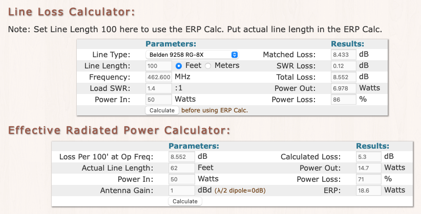

WRYZ926 Posted September 17, 2025 Posted September 17, 2025 On 9/15/2025 at 6:23 PM, WSHL459 said: I'm in the same boat with a J-pole antenna, 50 feet of RG8X coaxial cable to a lightning arrester, and another 12 feet to the radio. Get rid of the RG 8X. RG 8X has 86% loss per 100 foot on GMRS frequencies. SO if you are running a 50 watt radio on high power and actually getting 50 watts out at the radio, you are only getting an ERP (effective radiating power) of 18.6 watts out at the antenna. I did the calculations using the https://kv5r.com/ham-radio/coax-loss-calculator/ . As you can see, I used 462.600 MHz with an SWR of 1.4 and an antenna gain of 1 dBd. Even if you have a perfect 1:1 SWR at the antenna, you would still only get an ERP of 18.9 watts. WRTG549 1 Quote
