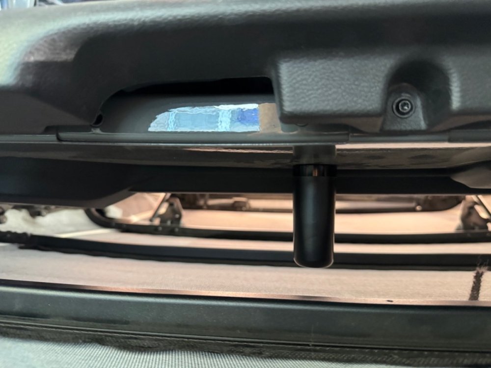

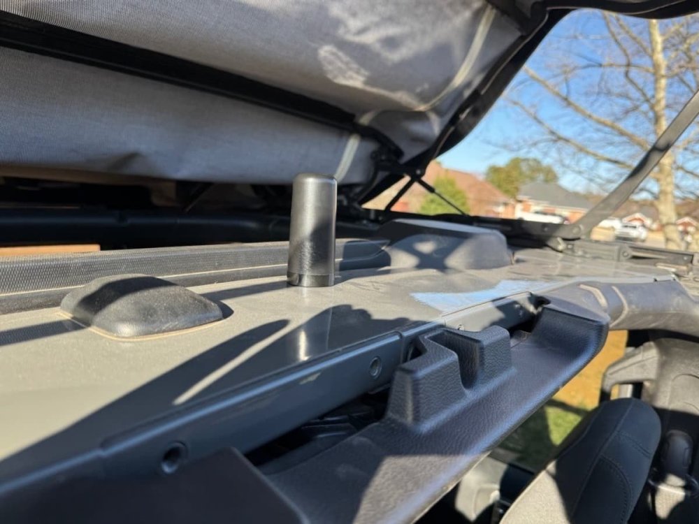

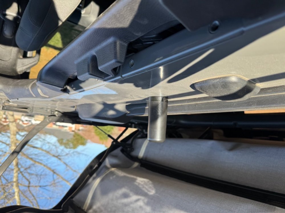

WRQS499 Posted March 12, 2025 Posted March 12, 2025 Is there any reason this would not be a good install location for the midland ghost antenna on my JLU? Not sure why the pics are upside down Quote

1 WRQS499 Posted March 12, 2025 Author Posted March 12, 2025 9 hours ago, Hoppyjr said: OK, looks like the speaker bar. We looked at this location in our JKU and decided against it, partly because we use both hard and soft tops and it won’t clear hard top. Also because we wanted the antenna outside of the cab. We also wanted a low-vis solution to minimize the chance of damage or vandalism. With those factors in mind, we installed to the removable piece at base of windshield. Super easy install, great reception, no issues. We also chose a Pulse-Larsen LP450NMO instead of Midland version, as the Larsen is lower profile. I used the Midland first on my Toyota, then swapped to the Larsen and found better performance. That’s the roll bar on the JL. It’s flat approx 10 inches wide and spends the entire width of the vehicle. It clears the soft top fine. It’s probably to most horizontal metal on this vehicle aside from the hood. SteveShannon and WRUU653 2 Quote

0 OffRoaderX Posted March 12, 2025 Posted March 12, 2025 1 hour ago, WRQS499 said: Is there any reason this would not be a good install location for the midland ghost antenna on my JLU? Not sure why the pics are upside down Fixed them for you.. That spot is fine as long as your soft-top doesn't tear it off, but heed this warning: "Some people" are going to proclaim that ghost antennas are "no good" and "dont work", or that your location is not "perfect" enough.. These people should be ignored with extreme prejudice. SteveShannon, WRUU653, WRYZ926 and 1 other 4 Quote

0 WRYZ926 Posted March 12, 2025 Posted March 12, 2025 1 hour ago, WRQS499 said: That’s the roll bar on the JL. It’s flat approx 10 inches wide and spends the entire width of the vehicle. It clears the soft top fine. It’s probably to most horizontal metal on this vehicle aside from the hood. That will work fine as a ground plane. You are slightly below the minimum radius front to back but have more than enough ground plane left to right. The minimum ground plane is a 1/4 wave length radius which is 6 inches for GMRS frequencies. And the ground plane does not have to be solid metal either. I have one of those expanded metal cargo racks on the back of my SxS that works well with my Comet 2x4SR antenna on 2m, 70cm, and GMRS. The only concern I would have is possible interaction from the soft top cross bars. That may or may not be an issue for you. For Negative Nancy - the soft top material should not be an issue since radio waves can pass right through the material. A fiberglass hardtop again should not be an issue either. WRUU653 and SteveShannon 1 1 Quote
