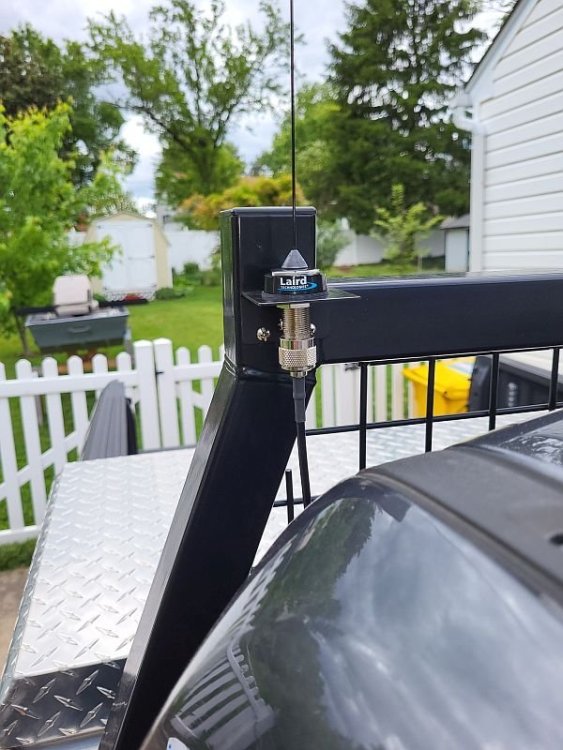

WSEZ864 Posted April 15 Report Posted April 15 I considered buy one of those mounts for my 2020 F-150. It too had a sunroof that precluded installing a regular NMO mount. I installed a "Back Rack", which I use to haul canoes, ladders and lumber anyway, and mounted two antennas on the vertical bars at the sides. VHF on one side, UHF on the other. The Back Rack is bonded to the truck bed and the bed is bonded to the cab. I brought the cables in under the rear seat, under the carpet to the front seats, where my radios are hung. Works 'OK', but not quite a well as the NMO in the center of the roof on my last truck. WRUU653 and RoadApple 1 1 Quote
WRUE951 Posted April 15 Report Posted April 15 2 minutes ago, WSEZ864 said: I considered buy one of those mounts for my 2020 F-150. It too had a sunroof that precluded installing a regular NMO mount. I installed a "Back Rack", which I use to haul canoes, ladders and lumber anyway, and mounted two antennas on the vertical bars at the sides. VHF on one side, UHF on the other. The Back Rack is bonded to the truck bed and the bed is bonded to the cab. I brought the cables in under the rear seat, under the carpet to the front seats, where my radios are hung. Works 'OK', but not quite a well as the NMO in the center of the roof on my last truck. And you probably paid less for the rack.. I have one of the 3rd brake light antenna mounts and knowing what i know now, i wouldn't pay $150 bucks. It is a quality milled piece of metal with a decent coax but it is a waste of money at the end of the da. I like the rack idea. Never thought of that. Quote

WSEZ864 Posted April 15 Report Posted April 15 2 hours ago, tcp2525 said: I too have an F150 and the power sunroof is not an issue. Plenty of room for an NMO mount. Maybe so, but it didn't look like it on mine. Mine has the retractable cover inside, side-curtain air bags, plus the regular glass window and by the time I avoided all of those items, I decided it wasn't worth trying to squeeze in there. The truck body is also aluminum and rather soft, so I was already on the edge of not using an NMO on the roof. https://www.ar15.com/forums/outdoors/Installing-Antennas-and-Radio-on-2020-F-150-Crew-w-Sunroof-Now-with-Moar-BackRack-/22-705121/ WRUU653 1 Quote

RoadApple Posted April 15 Author Report Posted April 15 @WSEZ864 Thanks for the suggestion about the back rack, and for the photo! Very helpful. That is certainly an interesting option worthy of consideration. @WRUU653 Thanks for the A-Pillar suggestion. I do understand compromises... Cost isn't a primary consideration for me, but even so the 3rd tail-light mount is in itself sort of a compromise, rather than following the recommendation of the "drill-baby-drill" enthusiasts who advocate for just installing that NMO mount. While an NMO mount installed dead center of the roof of my truck cab might be the best solution for RF purposes, that isn't necessarily the best solution for my purposes. I've been browsing YouTube videos about removing the headliner as was suggested by @WRUE951 and unless you are someone who does that sort of thing all the time, it appears like it could potentially be a PITA that is not without its own considerations and complications. In the process, I've also stumbled across a great many videos regarding replacing or fixing a 3rd taillight on these trucks. Some replace it for the purpose of a cargo/5th wheel bed camera, others for brighter or flashing LED lights etc. Many people with many different reasons. However, there are also folks that speak of damaged headliners as a result of leaks from a worn 3rd taillight lens gasket. Many suggest that it is not "IF" it will eventually leak, but rather "WHEN" it will leak, and they advocate replacing the gasket and resealing these 3rd taillight assemblies with silicone as a preventative measure. Something to think about... Interestingly enough that gets me back to my original post about this type of antenna mount where I asked those with direct experience using these devices: "Do they leak?" I'm thinking of an antenna being pushed by wind or by hitting trees, etc. and wonder how that might contribute to breaking or otherwise compromising that watertight seal around the mount? IOW, if these 3rd taillight assemblies are prone to leaking, maybe introducing an antenna mount there would be inclined to make matters worse. Absolutely nothing is without compromise!! Again, thanks for the comments and feedback on the topic. WRUU653 1 Quote
