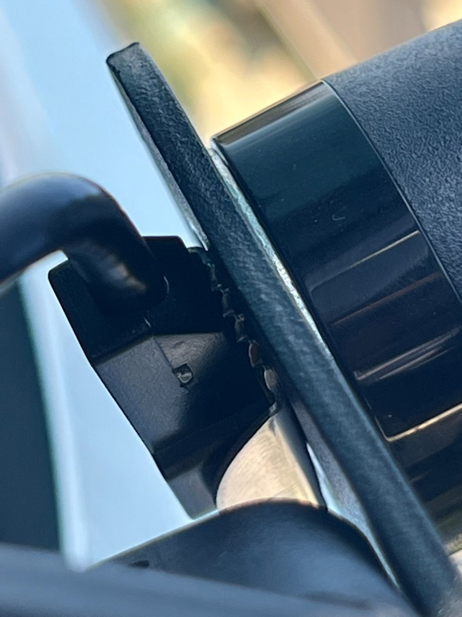

SWR of 1.75, can i do better or leave it as is?
TxHunter777 replied to TxHunter777's question in Technical Discussion
I suppose I could fabricate a metal enclosure vs the thrown together wood mount i did. The wood mount was made with just left of materials i had which was part of the fun, and fits surprisingly perfect. -
Yeah I will do that next. I very rarely use these ditch lights anymore, so I am not concerned with running them at the same time. Considered even taking them off, but since they are already wired up, i left them on. -
I swapped the Stainless steel washer from the bottom to the top of the mount. Tightened it down as tight as it will go. Teeth are closer, but not digging in to the bracket. Looks like the teeth are not pointed up, they are more pointed out. Perhaps without the stainless steel washer i can get closer, but I am needing to use a stainless steel washer because the mount i received has a .7" hole vs a 3/8" required for the NMO mount. Ran test again with this setup and no visible changes in swr. I can explore getting a bracket designed specifically wiith a 3/8" (midland sells one but its like $25 vs the $8 i spent), but i am not sure if i will see any changes in swr. - Today
LeoG replied to TxHunter777's question in Technical Discussion
Cover the driver/power supply with tinfoil to see if it reduces. If it does put it in a metal box. Unless it's already surrounded by metal cause in that case you're done. -
