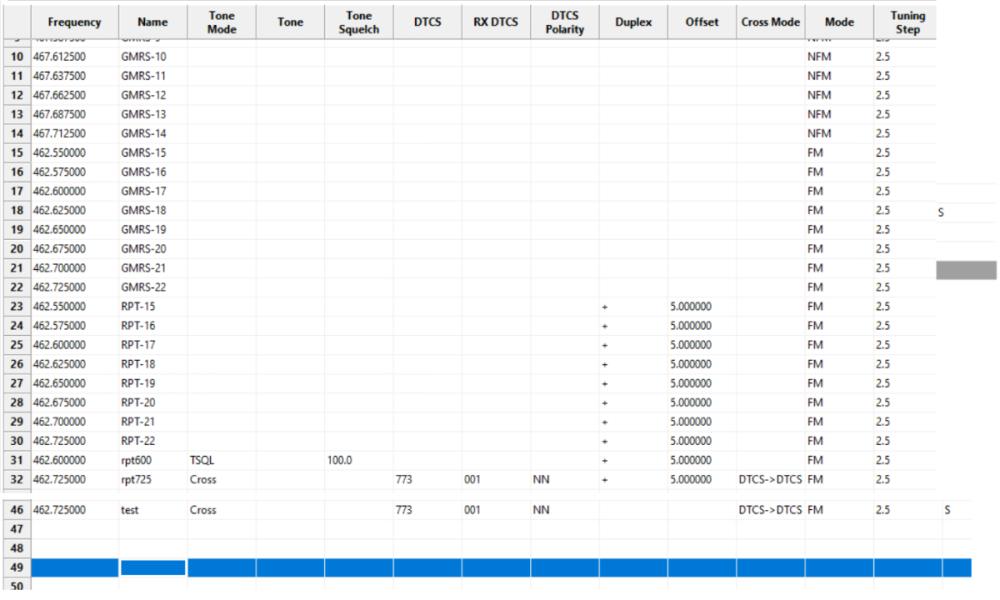

There is a problem that will prevent me from using Chirp to write to the DB20-G.  After downloading channels, there are 2 channels (22 and 38) highlighted in red which have a mouse-over notice that says list index out of range.  Both of these are set to .725 with split DCS tones.  Other channels with same frequency but CTCSS tone are OK, and so are channels with DCS same on both in and out.  I'll have to stick with the company software until Chirp developer(s) fix this.

Update: I added a fake channel (.625 simplex on 44) with split DCS tones (1N, 2N) and Chirp read that OK.  So I don't know exactly what combination triggers the error.
Update2: Added another fake channel (.725 simplex on 46) with split DCS (773N, 1N) and this one does generate the error.  And, tried a couple more combinations... doesn't appear to be related to frequency, just DCS split.
Update2: Added another channel (.725 simplex on 46) with split DCS (773N, 1N) and this one does generate the error.  And, tried a couple more combinations... doesn't appear to be related to frequency, just DCS split.
Does it do it if you program in the DCS split tone through the OE software? If so, then it might be something weird with the radio. if not, then it'd be worth reporting the issue to Chirp so it can potentially be corrected/
That doesn't make any sense to me.  I'm not going to write to the radio until Chirp can read from it without errors.
That's because I mis-read where exactly the issue was, sorry. Yeah, it definitely sounds like Chirp then, if you were able to program the same split in using the OE software.
I don't have split tones on any of my gear stuff, fwiw, and it seems to work fine.
EDIT: playing around with this, I'm not able to replicate the issue. I'm running it on Linux at the moment, so MAYBE that has something to do with it, but I'm able to get both a simplex and a repeater channel with split DCS tones put into Chirp without it complaining.
