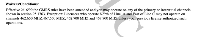

WRYZ926 Posted January 9 Posted January 9 I received my GMRS license in October 2023 and it has the Line A restriction on it. I downloaded a copy from the FCC website in late 2024or early 2025 and the Line A restriction was no longer on my license. If the Line A restrictions for GMRS were still in plane you would see it on your license under Waivers/Conditions. Here is the Line A restrictions on my license from October 2023 The copy I downloaded later looks like what @amaff posted above. WRUU653, amaff and SteveShannon 3 Quote
