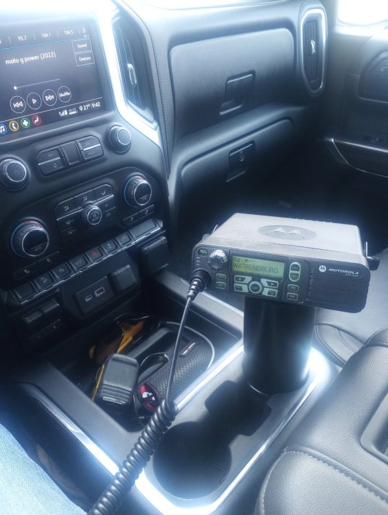

Newb Posted July 13, 2022 Report Posted July 13, 2022 Need an inexpensive cup holder mount for your small GMRS mobile? Try a 3" plumbers test plug. I got mine at Menards. Hairbear, wayoverthere, WRXB215 and 13 others 14 2 Quote

0 Newb Posted November 25, 2022 Author Report Posted November 25, 2022 I have switched from the small light weight radio shown in the first post to an iCOM IC f221-1 which is larger and heavier. I will post the simple mods I made that make it sturdier for the heavier radio. When you get your plug, note that I removed the nut and turned the top cap over as I couldn't see that the taper on the bottom side did any good and the flat side seemed to create more down force on the taper at the bottom of the stem. MichaelLAX 1 Quote

0 Newb Posted November 25, 2022 Author Report Posted November 25, 2022 https://forums.mygmrs.com/profile/5516-wrbu527/ The white ring is a 1/2" section of 2" schedule 40 PVC. Hit your local plumber up for a scrap OR have him cut you a piece. Center a 1/4" hole in the top of the body of the plug. Reassemble the plug. I used a 3/4" - 1/4"x20 bolt, the two washers and a nyloc nut. The big washer is 1/2" which fits the top of the body snug. The small wash is metric, it will drop to the bottom of the hollow body yet will fit the 1/4" bolt. Use a 7/16" nut driver to attach your radio's mounting bracket to the of the body of the plug with the nut and small washer inside the body. WRUX516 1 Quote
