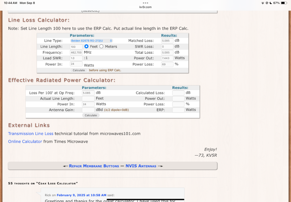

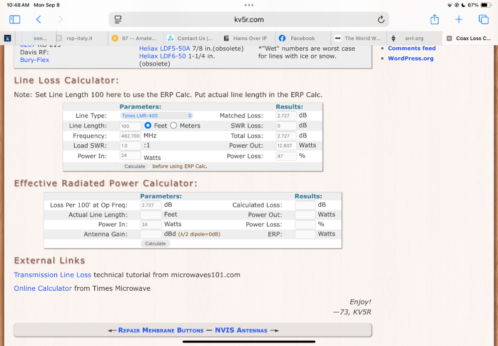

WSEL330 Posted September 8, 2025 Posted September 8, 2025 3 hours ago, SteveShannon said: Unless you like spending money with nothing of consequence to show for it, I wouldn’t. The difference in range between 24 and 48 watts will be nearly zero. Think of it this way: if your radio has a signal strength meter that displays the strength of your received signal, one S-unit is equivalent to 6 dB. In other words, to go from S8 to S9, you would have to quadruple your RF output power. Second, please tell us how and where you measured your output power and what kind of coax cable you have going to your antenna. Specifically, have you measured your RF output right where the coax connects to the antenna? A lot of times people unintentionally convert their radio’s output power to heat by using the wrong coax for UHF. So, how long is your coax and what type is it. Also, sometimes placing your antenna below the canopy will get you through vegetation better than raising it up into the thick part of the vegetation. I measured output power at the TX of my kenwood TKR 850. I also measured coming out of the duplexer at the antenna plug. I am using RG213 and/or KMR400 (swapping back and forth in testing). The cable length is 100'. My comment for increasing power was not for gaining distance as a know that does work that way. I was more interested in foliage penetration. This tree is above canopy but the lower portion of it's foliage is at the rest of the trees canopy thus wanting to penetrate better. I can not speak to the tune of the duplexer but my SWR meter says 462.702 (the Freq i want). I do not remember the sales facts but I will update later after work but I feel good about the tune for the seller. Audio quality does not appear to be an issue for this novice ear. Antenna is a HYT(T) whatever tuned to that freq. I think it is 3db gain?. marcspaz and SteveShannon 2 Quote
LeoG Posted September 8, 2025 Posted September 8, 2025 You mean to avert losses in that cable. 100' is when you start getting into hardline. Heck, 50, 60 feet is when you start getting into hardline for UHF. marcspaz 1 Quote
SteveShannon Posted September 8, 2025 Posted September 8, 2025 20 minutes ago, WSEL330 said: I measured output power at the TX of my kenwood TKR 850. I also measured coming out of the duplexer at the antenna plug. I am using RG213 and/or KMR400 (swapping back and forth in testing). The cable length is 100'. My comment for increasing power was not for gaining distance as a know that does work that way. I was more interested in foliage penetration. This tree is above canopy but the lower portion of it's foliage is at the rest of the trees canopy thus wanting to penetrate better. I can not speak to the tune of the duplexer but my SWR meter says 462.702 (the Freq i want). I do not remember the sales facts but I will update later after work but I feel good about the tune for the seller. Audio quality does not appear to be an issue for this novice ear. Antenna is a HYT(T) whatever tuned to that freq. I think it is 3db gain?. Okay, with 24 watts going into the duplexer end of 100 feet of RG-213 you get roughly 7.44 watts out of the antenna end of the coax. With LMR400 (I don’t know how KMR400 compares) the output is better than 12 watts at the antenna end. Quote
marcspaz Posted September 8, 2025 Posted September 8, 2025 16 minutes ago, LeoG said: You mean to avert losses in that cable. 100' is when you start getting into hardline. Heck, 50, 60 feet is when you start getting into hardline for UHF. Yep. My home repeaters and my portable repeater are all capped at 50', using LMR400. Hard line, even ultra flex, is too stiff for portable use. So, I keep it short. LeoG and SteveShannon 2 Quote
