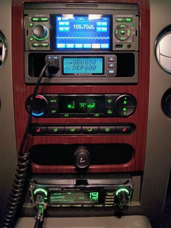

warthog74 Posted April 13 Report Share Posted April 13 Spent the afternoon ripping my dash apart. I had ordered an aftermarket stereo and mounting/wiring kit that arrived today. As i was putting the kit together i noticed the tray under the stereo looked tall enough and deep enough for my Leixen VV998 dual band radio. Sure enough, it fit nice and snug. I drilled out the back of the tray to run the coax and power cable, and made a few more holes for venting. The radio has a setting to use the microphone as a speaker so i didn't have to worry that i covered the internal speaker or find room to mount an external speaker. I think it looks good, and it sits flush with the stereo face plate. While i was at it i got rid of the mag mount, and finally installed the NMO hood mount. JBRPong and Hoppyjr 2 Quote Link to comment Share on other sites More sharing options...
WRQC527 Posted April 13 Report Share Posted April 13 Nice. I was able to do the same thing in my Sienna with my FTM-7250 with the useless cubby. warthog74 1 Quote Link to comment Share on other sites More sharing options...
WRXR255 Posted April 13 Report Share Posted April 13 The lady on top looks horrified, so im not sure its good. warthog74 1 Quote Link to comment Share on other sites More sharing options...

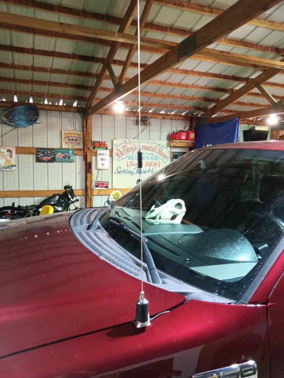

WRXP381 Posted April 14 Report Share Posted April 14 What antenna is that on the lip mount? Obviously it’s a no ground plane antenna? Quote Link to comment Share on other sites More sharing options...
warthog74 Posted April 14 Author Report Share Posted April 14 2 hours ago, WRXR255 said: The lady on top looks horrified, so im not sure its good. Lol. That’s Alissa White-Gluz. Quote Link to comment Share on other sites More sharing options...
warthog74 Posted April 14 Author Report Share Posted April 14 1 hour ago, WRXP381 said: What antenna is that on the lip mount? Obviously it’s a no ground plane antenna? Browning MURS / GMRS tuned antenna i got about 9 years ago before my original GMRS license expired. It came with a mag mount. I’m guessing it uses the metal from the vehicle for a ground plane. Here’s the Ebay Link. Quote Link to comment Share on other sites More sharing options...
WRXP381 Posted April 14 Report Share Posted April 14 11 minutes ago, warthog74 said: Browning MURS / GMRS tuned antenna i got about 9 years ago before my original GMRS license expired. It came with a mag mount. I’m guessing it uses the metal from the vehicle for a ground plane. Here’s the Ebay Link. I would just be concerned you’re not getting the greatest ground plane with that antenna mounted on the edge of the hood like that. Cb antennas would work fine that way but a uhf ground plane antenna usually would needs 12” min all the way around and to be above the cab/passenger compartment. It’s seams that may be a very front right heavy transmit and receive location. Quote Link to comment Share on other sites More sharing options...
warthog74 Posted April 14 Author Report Share Posted April 14 It will have to due. So far it seems fine in my brief testing this afternoon. Not many options on a truck with a bed liner and tonneau cover and your garage door is only 7’ tall. At least it looks better than a mag mount tossed in the center of the hood. Sshannon 1 Quote Link to comment Share on other sites More sharing options...
tcp2525 Posted April 14 Report Share Posted April 14 Very nice install. If you have a GMRS radio with a detachable face you can always use the sunglass holder, which will fold up when not in use. I put the ham radio there and the GMRS in the center counsel storage. Both are hidden when not in use. warthog74 and WRZK593 2 Quote Link to comment Share on other sites More sharing options...
warthog74 Posted April 14 Author Report Share Posted April 14 Slick. Sadly no sunglasses holder as this truck has a sunroof. I thought about detaching the face of my TYT TH9800 and putting it in the tray if this didn’t work out, but glad it did. I like keeping the TYT in the house as a base unit. If something happens to the Leixen it’s only a $70 loss. It’s basically a glorified Baofeng HT in a mobile form factor, but it works well enough and is capable of 25w if needed. Sshannon and WRZK593 2 Quote Link to comment Share on other sites More sharing options...

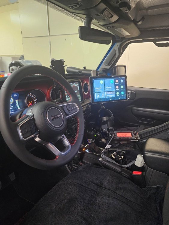

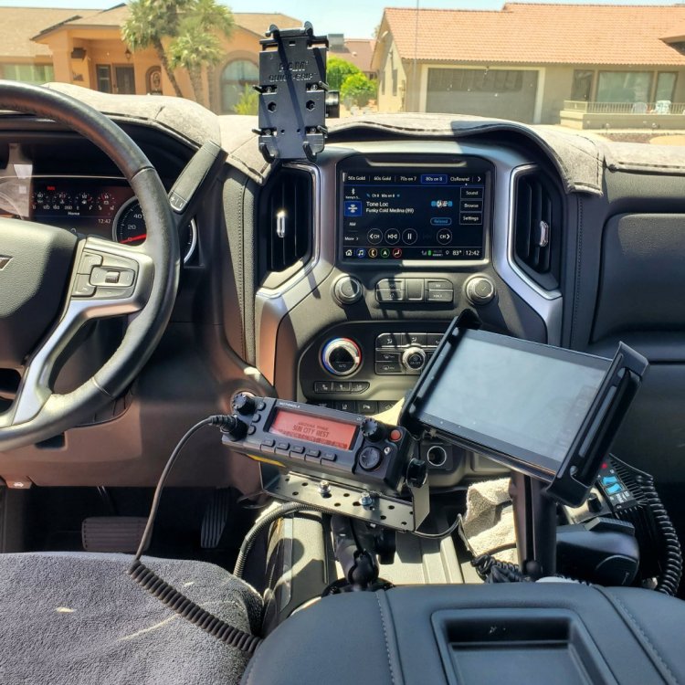

nokones Posted April 14 Report Share Posted April 14 My clean install in my Jeep Wrangler Rubi with nothing being ripped apart. warthog74, tcp2525 and Sshannon 3 Quote Link to comment Share on other sites More sharing options...

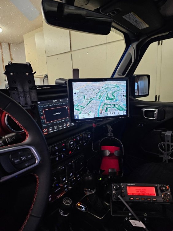

nokones Posted April 14 Report Share Posted April 14 My clean install in my Chevrolet Silverado with nothing being ripped apart. Sshannon and tcp2525 1 1 Quote Link to comment Share on other sites More sharing options...
warthog74 Posted April 14 Author Report Share Posted April 14 Neat. Too much clutter for me personally. My dog would have drool splattered all over those electronics in the center console. tcp2525 1 Quote Link to comment Share on other sites More sharing options...

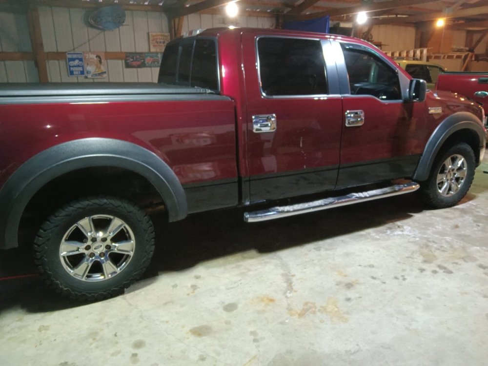

tcp2525 Posted April 14 Report Share Posted April 14 15 hours ago, warthog74 said: Slick. Sadly no sunglasses holder as this truck has a sunroof. I thought about detaching the face of my TYT TH9800 and putting it in the tray if this didn’t work out, but glad it did. I like keeping the TYT in the house as a base unit. If something happens to the Leixen it’s only a $70 loss. It’s basically a glorified Baofeng HT in a mobile form factor, but it works well enough and is capable of 25w if needed. What make and model is your truck? I was assuming it is a newer F150, but I'm not rally sure. Mine is an older F150 with sun roof. Quote Link to comment Share on other sites More sharing options...
warthog74 Posted April 14 Author Report Share Posted April 14 12 minutes ago, tcp2525 said: What make and model is your truck? I was assuming it is a newer F150, but I'm not rally sure. Mine is an older F150 with sun roof. It's an older ’06 F150 Lariat SuperCrew 4x4 with 237,000 miles on it. The rims are from a 2018 F150. Still runs like new. Quote Link to comment Share on other sites More sharing options...
tcp2525 Posted April 14 Report Share Posted April 14 2 minutes ago, warthog74 said: It's an older ’06 F150 Lariat SuperCrew 4x4 with 237,000 miles on it. The rims are from a 2018 F150. Still runs like new. Very nice! I have a 2013 Limited. I finally upgraded to 20" wheels from a 2023 F150 after ruining two 22" rims from Baltimore potholes. I love the 20s and wished I did it sooner. warthog74 1 Quote Link to comment Share on other sites More sharing options...
