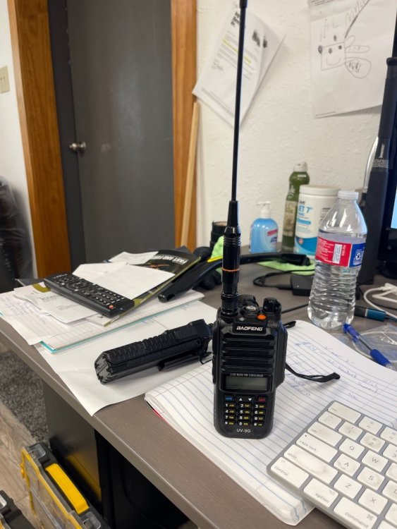

n2877 Posted May 20, 2024 Report Posted May 20, 2024 13 hours ago, jsneezy said: How far away are the closest repeaters? I've been able to hit some around 70 miles away with my UV-9G both with the rubber ducky and NA-771G. there about 20 miles away. But every time I've tried I get dead air. Then next thing I know, people are talking. It got what ever antenna it came with. It's not the rubber duck. IMG_0019.HEIC Quote
n2877 Posted May 20, 2024 Report Posted May 20, 2024 (edited) This is what I meant to put in message, sorry Edited May 20, 2024 by n2877 an oops Quote
n2877 Posted May 20, 2024 Report Posted May 20, 2024 I forget that iPhones store pictures differently than other phones. Not sure who makes the antenna that is attached to the radio, there is a bnc-sfma adaptor between radio and antenna fyi. Quote

SteveShannon Posted May 20, 2024 Report Posted May 20, 2024 18 minutes ago, n2877 said: Thanks for not waisting any of my “valuable time” with letting my down easy by going into a lengthy explanation as to why you can’t. He doesn’t have a magic wand. Or He doesn’t know why you can’t hit the repeater (you’ve given no details). Or You’re not his favorite viewer? What kind of challenges do you have in reaching the repeater? What’s the terrain like? What about vegetation? Do you have the right tone for transmitting? Quote

jsneezy Posted May 20, 2024 Report Posted May 20, 2024 4 hours ago, n2877 said: That just might be a good idea for me to do. Now can you wave your magic wand for your favorite viewer and get my current uv-9g to reach the repeater that is about 20 miles away with current set up please? Double check your tones. I was on the mobile out of town a few weeks ago, and tried hitting the local repeater there. Somehow, I managed to mix up the split tones for the repeater and couldn't hit it. It wasn't until I got home and double checked the Radioddity software that I realized I had the right tones saved, but they were backwards. Also, just to rule it out, I would try putting the antenna directly on the radio rather than having the adapter(s). Quote
